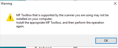

06-12-2016 05:26 PM - edited 06-12-2016 05:29 PM
Patch did nothing for me. Updated the drivers + installed the patch.
services.msc was already checked under the that setting as well.
What's weird is I have 2 windows 10 computers on the network. ON one computer the scanner works... on the other I keep getting the
"install the appropriate mf toolbox" error.

1) Go to Devices and Printers, right-click on the Canon MF driver and choose Scanner Properties. Click Yes on the UAC dialog. If the Scanner Properties window pops up, skip to step 10 below.
2) Right-click on the Canon MF device and choose Remove Device.
3) Unplug the USB cable.
3) Uninstall the Canon MF device driver software from Programs and Features.
4) Delete the MF4600 folder from C:\Windows\twain_32.
5) Reboot.
6) Install the latest Canon MF device driver software.
7) Open the C:\Windows\twain_32 folder in File Explorer and Devices and Printers to watch what happens.
😎 Plug in the USB cable and watch the driver auto-install.
9) Try step 1 again. If it works, continue. If not, then see the next section.
10) Test with Windows Fax and Scan. It should work immediately.
11) Uninstall Canon MF Toolbox if it is old (using Programs and Features).
12) Install latest version of Canon MF Toolbox (v18 as of this date). Rebooting and safe mode were not necessary for us.
13) Test scannng using Canon MF Toolbox.
14) Reboot and make sure it still all works.
