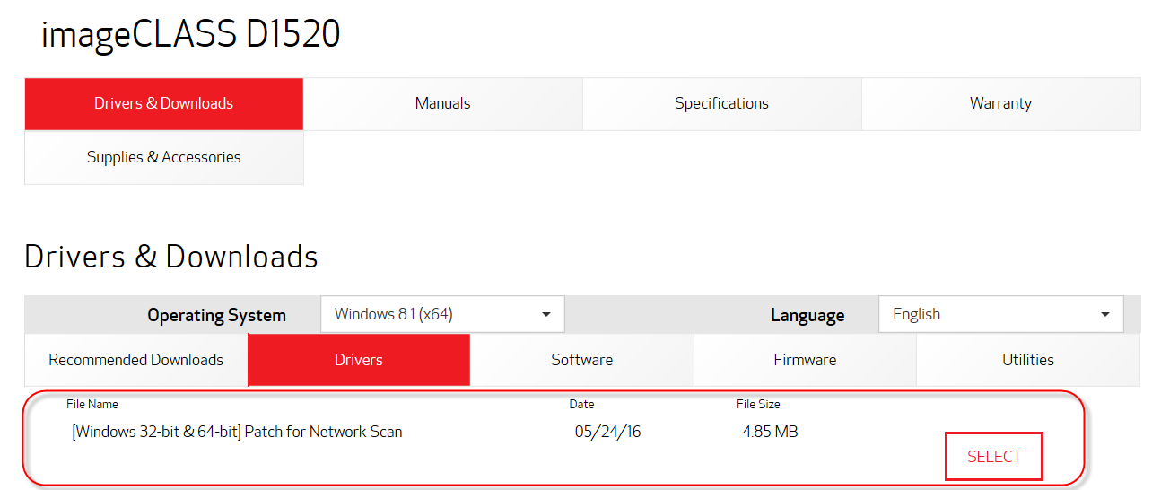

On Friday, May 27, 2016, Canon Inc. released a Network Scanning Patch for imageCLASS models. This Network Scan patch addresses the issue where the ability to scan over a network will stop working after an update to Windows 8, 8.1 and 10. By installing this patch, future updates on these versions of Windows will not affect your ability to scan using the imageCLASS over a network.
If you are NOT able to scan over a network, you should perform the following steps:
Please visit www.usa.canon.com/support and enter your imageCLASS model.
If you are currently able to scan over a network with your imageCLASS, you should still download and run the patch to ensure continued functionality, start at Step 3.
