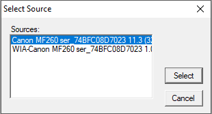

Hector, ScanGear MF window doesn't come up - there is a progress bar in the software and then it tries to scan from the glass.
I can use it in Canon utility, PaperScan, XnView (they all come up with ScanGear MF screen) or Nuance Advanced Power PDF (it has its' own and it offers WIA and TWAIN scanners in scan setup, but in Elite I see these 2 as Data Source and both of them do not show any options:
Are there some old TWAIN drivers somewhere in archives?
