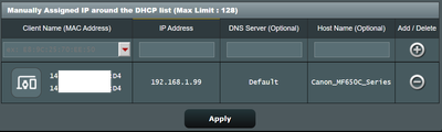

I have two Canon lasers, connected to two different networks, both using Asus Routers, wirelessly with absolutely no issues. While ethernet isn't subject to the same overhead as wireless, the latter works just fine and has been 100% reliable in both of my use cases. I do have both printers assigned using a static IP on the routers. (example below)
The first suggestion I always make is assign the device a static IP, the second would be updating the printer's firmware which can be done from the LCD panel if you scroll to the right. Look for "Update Firmware" icon. I have not made any changes to either device's power management settings, both sleep after 60 Seconds. Print jobs come from Android, iPhones, Mac and windows PC's. In some cases we use the Canon print app from the mobile devices.
Unfortunately, I have not been successful reproducing the reported issues. Both devices are present in the list of attached devices and can be pinged from another device on the network. Try upgrading the firmware on the printer and on your router if it's out of date. This is often helpful.
