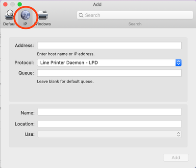

Hi Rick. Thanks for your help resolving my first issue. Now my printer is being removed periodically from the network (but otherwise working). So my question is, how do I assign the Canon printer a static IP on Mac?
08-04-2026 10:13 AM - edited 08-04-2026 10:15 AM
Greetings,
Where to start. Assigning a static IP Is done on your router. Depending on the brand and model, it may be called address reservation, static IP, etc. Note, when this is done on the router, you do not need to make any changes to the printers UI or programming. It's important to restart the printer after the assignment is made on the router.
Once that's done, you're ready to install it on your Mac or windows device.
If a printer instance exists in the printers and scanners applet, select it and use the minus (-) button to remove it. Now restart your Mac.
Return to the printer and scanners applet and look at the top of the interface next to the default add printer icon. Just to the right to the right, here's a globe. Select that.
On the first line, Address: enter the IP address you have reserved. You'll notice a few lines below that the IP address will replicate. Name: This field is editable. Give your printer a friendly name. (Example) MF663Cdw. Leave the Protocol field with the default selection.
The location field is optional. Some people include the printer's location. Office, downstairs or just leave it blank.
Down below there's a box marked Use:. Use the drop down to select the Canon print driver installed previously. If the printer was installed using air print previously, you'll need to install the driver in order for it to be selectable.
This is is an example. Your interface may look slightly different depending on your version of Mac OS.
When all the fields are populated you can click ok to add the printer.
instructions for @mcburb
