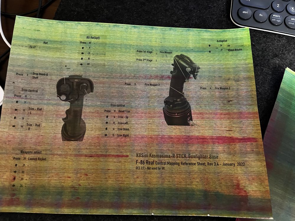

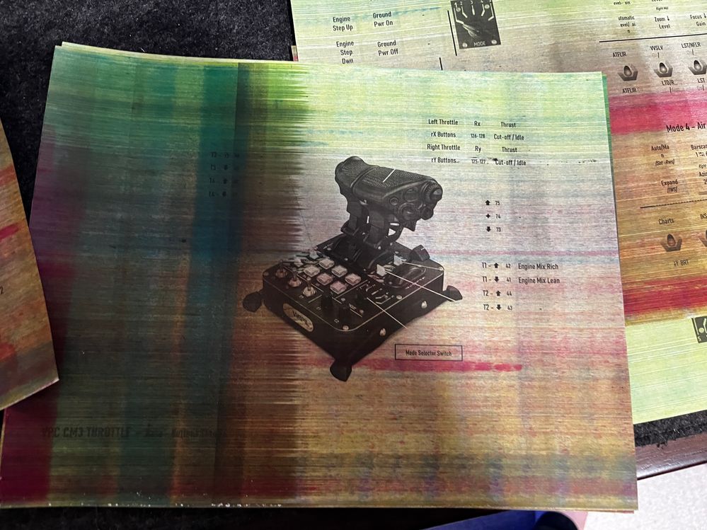

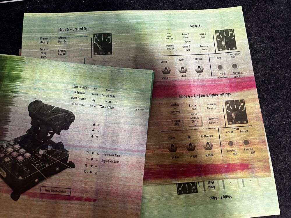

I own a 733cdw color laser and I recently the print quality has turned to crap.
I have run the various Maintenance / Cleaning Cycles 5x each at this point with no improvement. I am at a bit of a loss as what to try next.

- Wife also ran 50-60 prints on maybe a non-laser paper? I am not 100% sure since she didn't ask me about it but I think something could have happened if the toner did not adhere to the paper?
I have watched the available youtube videos that talk about cleaning and the transfer belt but I am not sure where to look if this is a cleaning issue? I hate to buy a new BLK toner just to rule out that cause. So any help would be awesome.
The printer was printing great before the updated BLK toner was added and my wife ran her "programs" but again I'm not sure what to try next. Thanks so much!

I have run the ITB cleaning routine many times without a change. I have inspected, and vacuumed the machine as best possible. There is no noticeable "dump" of toner. The cartridge's are genuine Canon.
I will try a copy, I have not done that recently.
