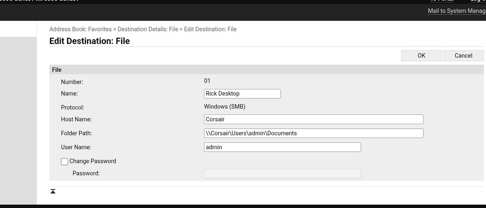

I suggest reconfirming the path to your destination PC / Folder. You can do this by logging into the remote UI and checking the entry in your address book. Here's my entry as an example, yours will look different since you're on a Mac.
02-18-2026 04:01 PM
Thank you, I suspect this is the issue. But I'm not a techie, just a home user. How do I find and log into the remote UI? And how do I find the IP address of the printer (or do you mean of my MacBook, which I can find). Thanks.
