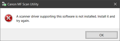

And yes, I've installed the MS Scan Utility. Some installs literally did nothing after starting from the provided shortcut. The latest, downloaded from your support page for the imageCLASS MF462dw II, is currently claiming there is no supported software driver installed. I've never seen a bigger mess of a product...

Oh, and someone says the driver isn't installed, it is. It was installed (more like updated) from the same download page as that utility, and it's printing as well as scanning from the face plate to the computer.

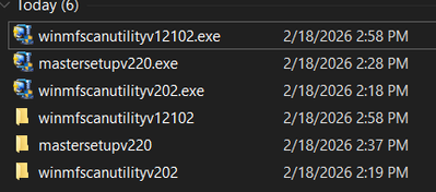

I couldn't tell you what all I tried in the past as I got frustrated each time and gave up. Until today, I could get by printing (which has worked fine all along) and doing brain dead image scans from the face plate. But today, I HAD to have an actual pdf document from a scan, so against every desire in my soul, I tried again. In any case, this is what I've installed today along with a firmware update the faceplate had been nagging about. Note that ALL of this was downloaded from the downloads at Cannon listed for my printer on Win10.

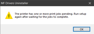

Hmm, while typing this, I recalled something that could be relevant based on your comment, but I don't think so since it would (should?) only impact the printer. My old printer was a MF4800, and there is a "Cannon MF4800 Series" entry in my Add/Remove Programs that I never could uninstall (still can't) because it says there is something pending in the Print Spooler. I just ran it again to get the actual message in case it matters. But there is no related device listed to access the spooler to clear, so there it remains. Could this be the root of the problem even though everything EXCEPT the Scan Utility works correctly?

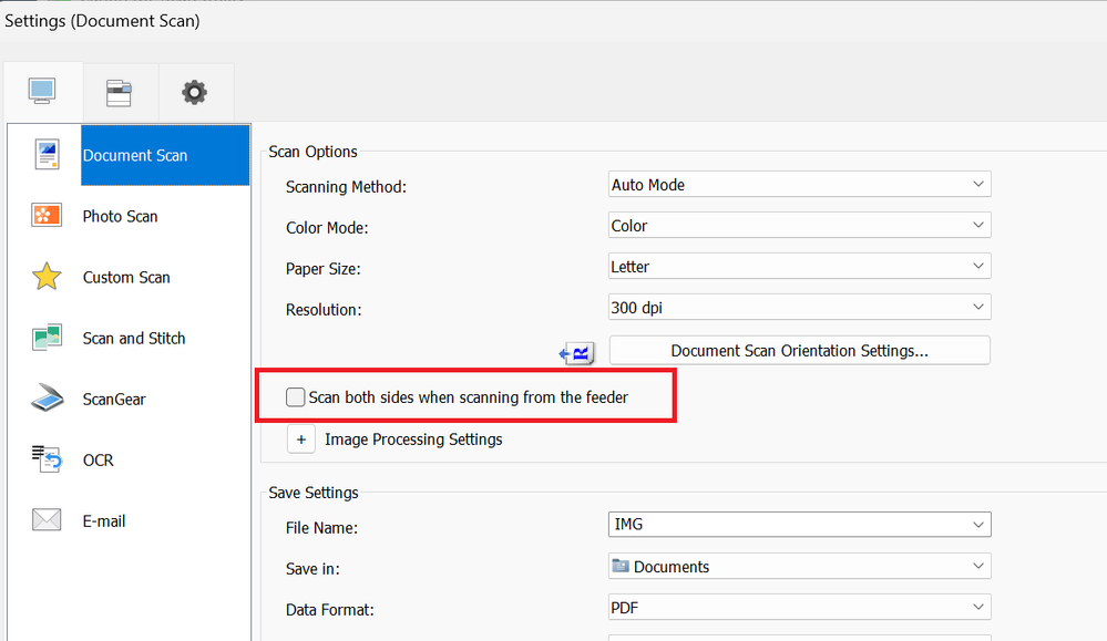

Note, ScanGear is its own application. It has advanced features that are great. I use it occasionally when I need absolute granular control of scanning. Typically the MF Scan Utility is more than enough, and you can tick the box that allows you to use the ADF for single pass duplex scanning. The feature you need. 😁

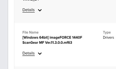

You only need 3 drivers for printing and scanning.
UFRII Printer Driver
https://pdisp01.c-wss.com/gdl/WWUFORedirectTarget.do?id=MDEwMDAxMjI2NzA5&cmp=ABR&lang=EN
The ScanGear Driver
https://pdisp01.c-wss.com/gdl/WWUFORedirectTarget.do?id=MDEwMDAxMjc3ODAx&cmp=ABR&lang=EN

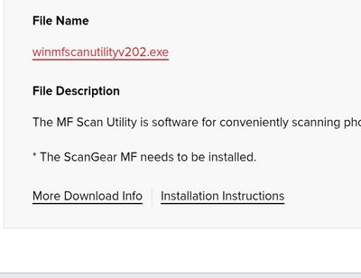

The MF Scan Utility
https://pdisp01.c-wss.com/gdl/WWUFORedirectTarget.do?id=MDIwMDAwNzE5ODAz&cmp=ABR&lang=EN
Note it says you need the ScanGear utility 😉

I could be mistaken, but I'm pretty sure I've installed everything on that page when I was chasing it one of the earlier times, though not today.

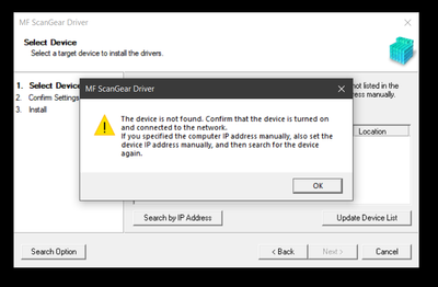

I downloaded what you suggested, and it completed successfully up the point where it couldn't find any devices to connect to. And I did select networked devices, and even made sure the printer was NOT in sleep mode (which it enters after something like 10 seconds it seems).

I tried the magic reboot and ran it again. Same issue. This time got the image capture for you.

If the printer is connected to Wi-Fi or ethernet you can use that button below that allows you to search by IP address. Optional but recommended I'm going to suggest that you assign a static IP to the printer on your router. Leaving a persistent device like a printer on DHCP will be problematic in the long run.
The issue is that the software is not seeing your printer. Once this is solved everything will start working

Printer properties show it on 10.0.0.27. Searching for that IP it still says no device found.
