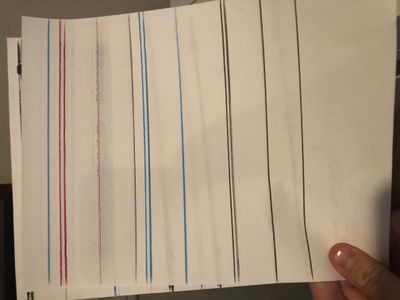

Every time I print copy or scan the image is just random horizontal lines. Has anyone ever had this issue. The cartridges still have about 50% life according to the printer. Whenever I try to adjust the printer settings it always fails.
06-21-2022 07:16 PM
same here and it is so frustrating. Was working fine all weekend, too. now, even though my toner carts are all at least 1/2 full, I'm out of luck.
From what I've seen, a lot of the troubleshooting steps suggest an issue with the toner, but for all 4 of them to all develop this problem? doesn't seem likely, and I would hate to spend money on new toner only to find it is a different problem.
06-22-2022 09:13 AM
something strange I've noticed. I'm using the latest MacOS, and I've been trying to print PDFs using the Preview app. There, I get these random horizontal lines. But, printing form other programs, such as Safari or Apple's Pages, things print fine.
So, @mike4311 - maybe check to see if you get different behavior from different applications? Very strange
06-22-2022 09:21 AM
also - I downloaded a 3rd party PDF reader (Foxit) and printed the same PDFs from that app, and they printed fine.
I should note that the horizontal lines I saw on my LBP622Cdw look exactly the same as those in your photo. Hopefully, this helps you

Same problem here, mine look just like yours but only black. It is NOT the toner. I changed the toner, plus it's totally random. It will print two pages clean, then several with these streaks. Same printer, running Windows 10.
07-01-2022 03:24 PM
I'm not the original poster, but same problem, same printer, only my stripes are black only. It's not the toner, I changed it plus the stripes are completely random. I'm running Windows 10 and cartridges are 045.
07-01-2022 03:50 PM
I eventually got things working again. At first, I thought these lines were introduced by the PDF reader program, but that turned out not to be the case. It would randomly print fine, then randomly have the lines. What eventually got things going was cleaning the fixing assembly a few times. It took a few repeated tries to get it to work, but now things print fine. this Youtube video shows the process (and provides a lot of other tips for cleaning this printer)
