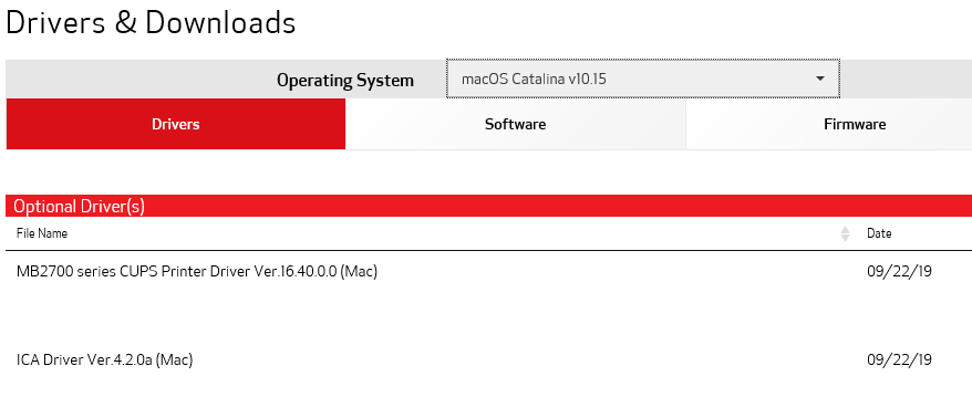

I see Catalina specific drivers available for your device.

Just downloaded this new driver, but the document feeder still does not pick up document to scan. it scans from the glass, but the document is left in the feeder. Any other suggestions?
