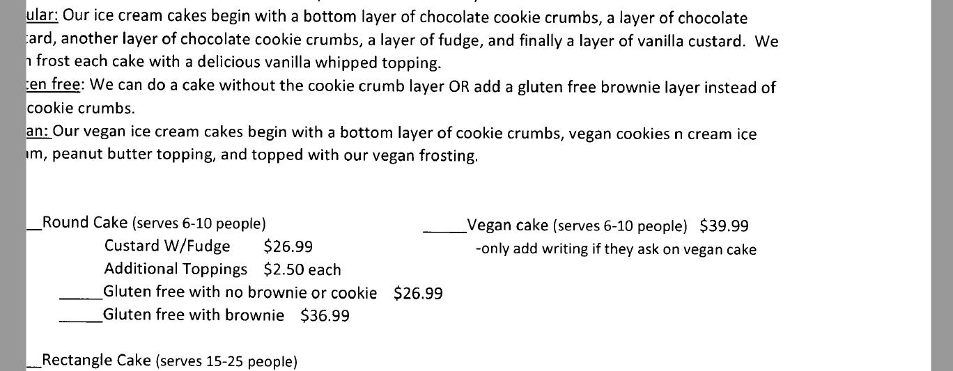

I have a brand new mf644cdw and am having the same issue. The trailing edge of the page is not captured by the scanner, just as sscharlau described. I'm losing 7/16" of the page, almost half an inch.
I checked the settings in MF Scan Utility as suggested, ensured the correct paper size was set, but that does not fix the problem. Size was set to Letter, I am scanning an 8.5" x 11" document.
The problem seems to be that the scanner does not correctly account for the Letter size document.
In MF Scan Utility settings, if I change the paper size to A4 (8.3" x 11.7") but scan a Letter (8.5" x 11") document, then the scanner captures the full long length, albeit with an edge artifact as part of the scan, but crops the short dimension by 0.2". This is acceptable for ensuring I get the entire page, but is not ideal.
I updated firmware yesterday when I installed the printer. Main Controller version is 6.03. Boot ROM and DCON are both 2.01. Drivers are from the 8/17/2020 version of MF642CMFDriverV6403W64.exe from the Canon support website.
Here is Letter size setting:
And here is the same document but with size set to A4:
Thanks,
Todd

Nope, that is not what is happening, and changing that parameter did nothing to change the behavior of the scanner.
The scanner is simply not scanning the last 1/2" of the document as it goes through the document feeder.
This has nothing to do with printing, I'm trying to capture a document into a PDF file. 3 of the 4 margins of the document are fine - they reproduce in the PDF just as they appear in the original doc. It is the last edge that flows through the feeder that is not being captured. It appears that the scanner stops capturing the image when there is still 1/2" of the original document still to go.
To repeat: I changed "Expand Print Region and Print" to ON as you directed, and repeated the scan. Exact same results.
