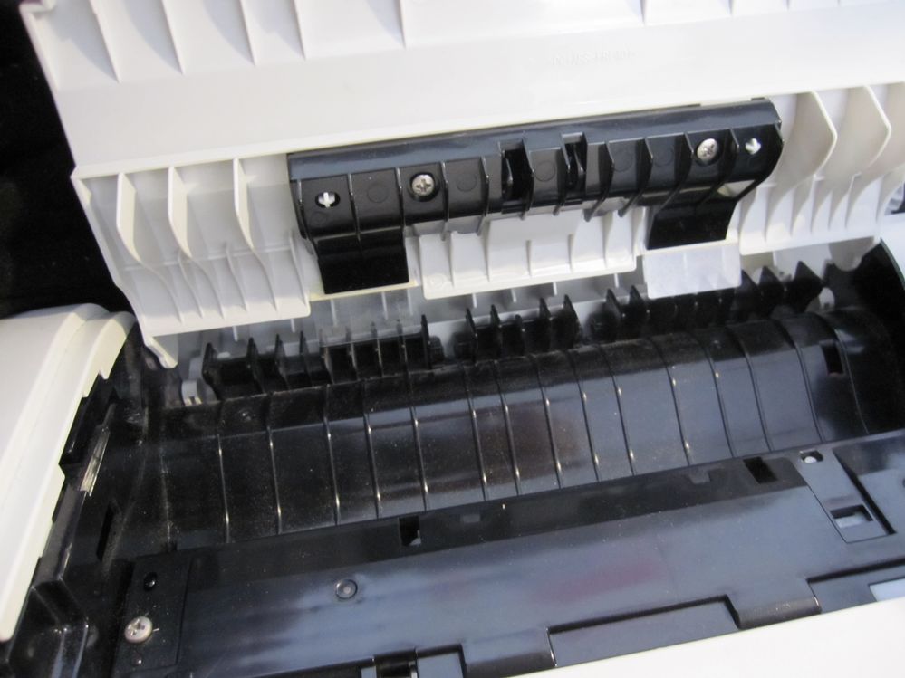

MF4890DW says An original is in the feeder (ADF) when there is no paper in the automatic document feeder on top of the machine. Is there something jammed in the ADF, I looked and there isn't anything there or even a mechanical sensor that is triggered when paper is inserted into the ADF. So when I put paper there to scan, it will scan to the last page and because it's always detecting paper there, it will error out as a paper jam at the last page when it thinks there's paper there and it couldn't grab the paper and so no scan file is created. Please help. Thanks

Please let me know where I can free the ADF paper sensor . thank you
WHEN No original was in ADF

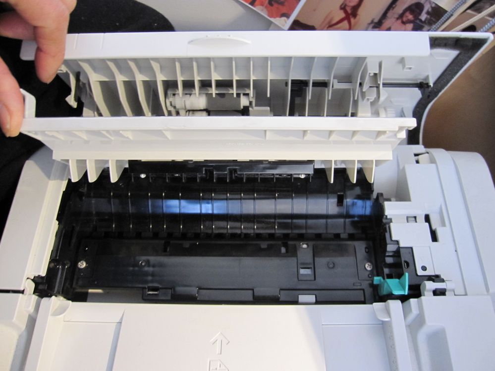

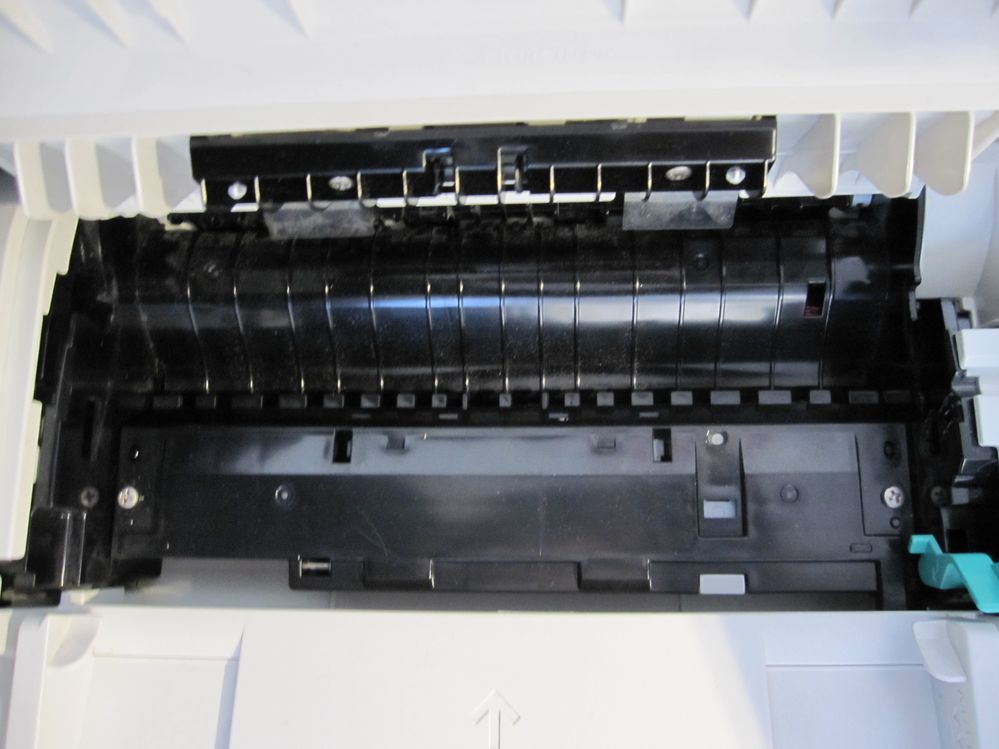

Hello TheNYCCharles,
If you do not see any obstructions in the path like in the images above, it looks like there is something wrong with the hardware or something is stuck in the path that you do not have access to. In this situation, you can try inserting a stiff/thick piece of paper into the slots in the ADF that the paper is pulled through and then pulling it back out. Cardstock, a sheet of 4X6 photo paper or an index card might be able to clear any obstructions in the path. If that does not resolve the issue, it looks like the printer needs service. You can check your available service options by logging into your MyCanon account or contacting support at 1-800-652-2666.
