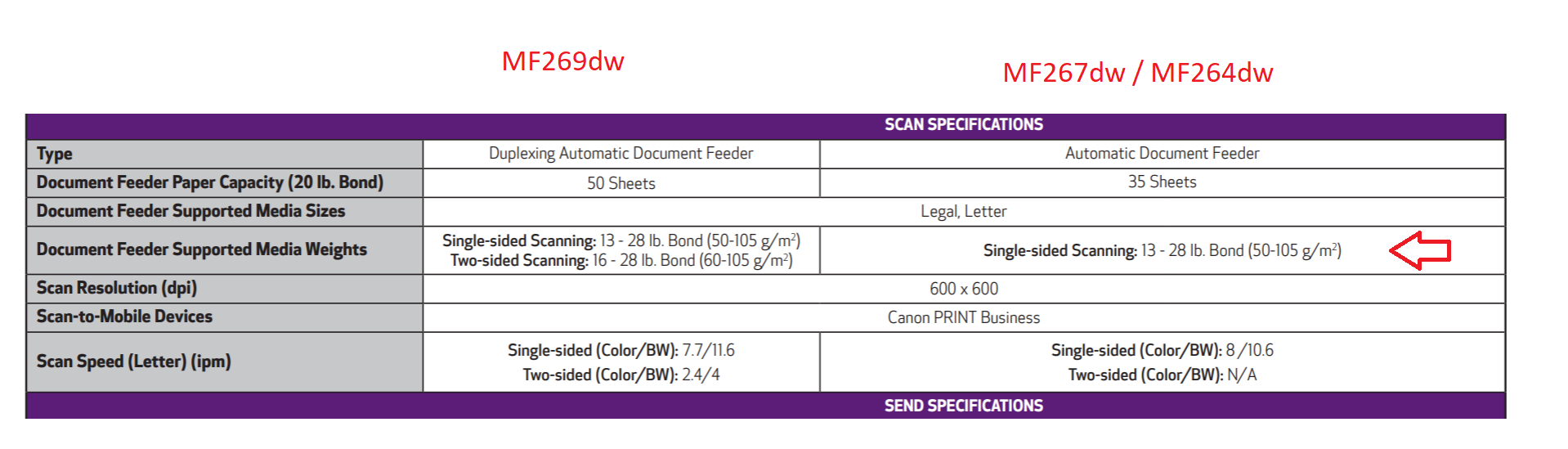

I just purchased an MF264DW printer. I have set it up to communicate with my router using a wired connection to be able to give commands with my iPhone. However, for copying specifically I can only use the controls on the printer itself. I'm trying to copy a double-sided page to a double-sided page but the only setting that appears in the copying setting menu is '1-> 2-sided'. I obviously want 2 -> 2-sided. I should see a '2 -> 2-sided' setting in the menu per the Canon manual but I don't. What am I doing wrong?
Solved! Go to Solution.
09-24-2020 01:08 AM
Greetings,
Because Canon lists specs for the 264, 267 and 269 on the same page. Interpretation can be tricky.
So here it is:
The 264 and 267 supports single sided scanning through the ADF
Duplex scanning is supported on the platten
The 269 supports duplex scanning through the ADF and on the platten.
The layout is pretty bad and difficult to interpret.

10-06-2020 01:25 PM
Hi,
Shadowsports got the right answer.
