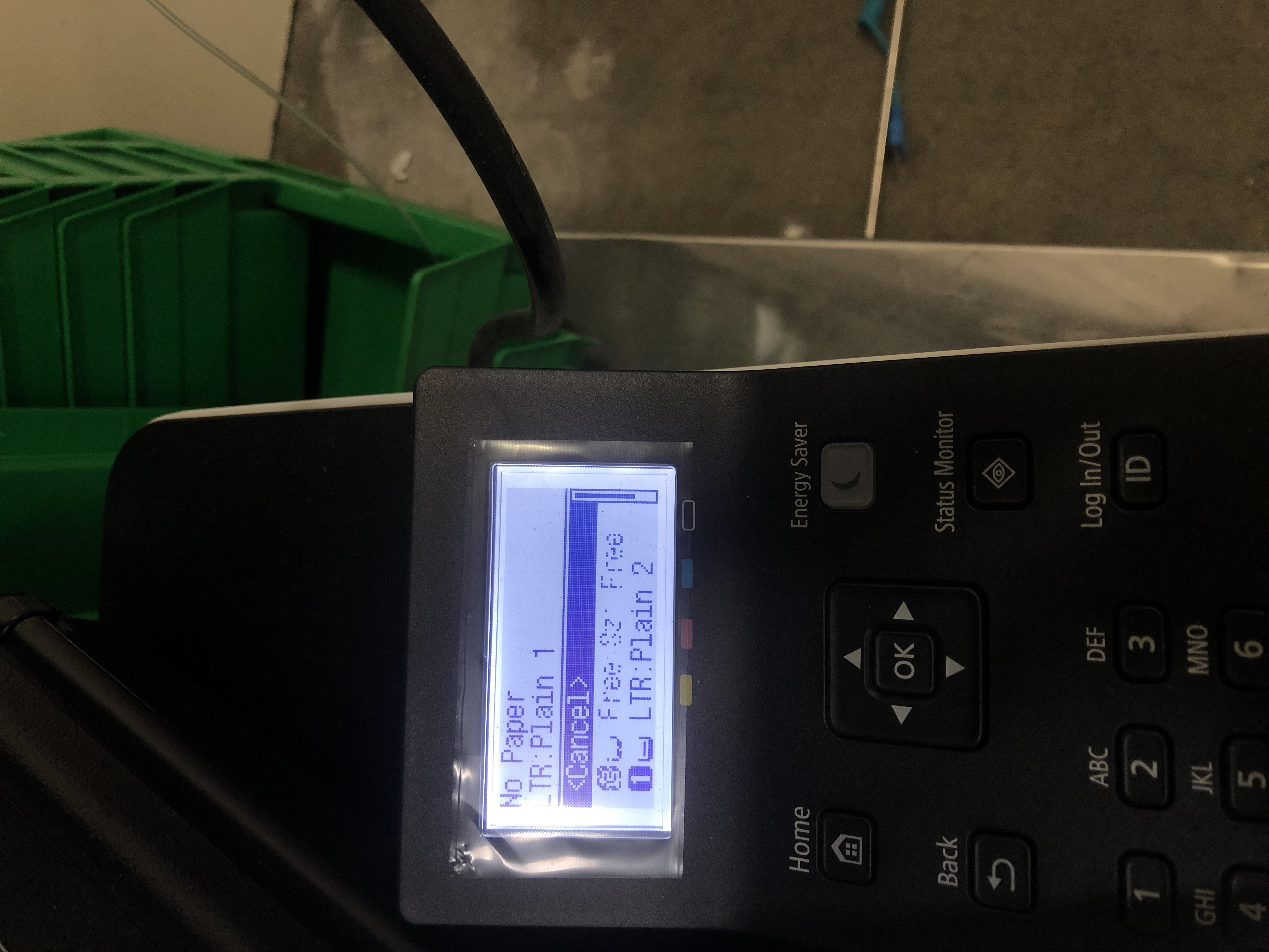

I'm having an issue with my LBP622C/623C which I can't seem to figure out. I have US Letter paper loaded in the paper tray (the one that slides out) and the display shows both correct size and that its loaded with paper. Every time I go to print a letter sized document the printer says "No Paper LTR: Plain 1" (see image). I have to select 1 (which is the paper drawer) and then it works fine. I have looked through all of the settings and can't find which one needs to be changed. I've even disabled the multipurose tray and it still does it.

12-23-2019 04:25 PM
Hi david_l.
The screenshot you provided indicates you're using IPP Drivers for the printer. Try removing that printer entry, then reinstalling using one of the UFR II drivers found on the LBP622Cdw Drivers & Downloads Page.
If your printer is an LBP623Cdw, then you will need to use the Canon Global website's map to find your region, and download the drivers from that website.
If you need immediate assistance with this issue, please contact us using the numbers and information at http://Canon.us/ContactLI

12-23-2019 03:34 PM
Hi david_l.
The screenshot you provided above shows the Printer Properties window. What is set for the paper type and source in the Printing Preferences settings (Paper Source tab)?

Hi david_l.

07-23-2020 06:19 PM
Thank you for this. I'd been cursing this printer for months owing to the same problem.
I had allowed Windows 10 to select the driver automatically.
