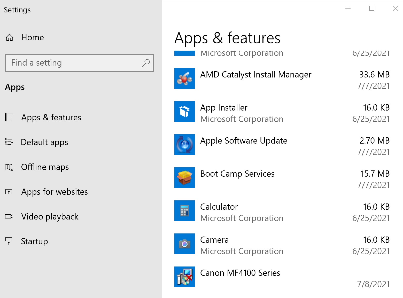

Hello Rick.  I had to walk away from this issue for a while but now I am trying to resolve it.   I got the Canon printer new.  I have an iMac Computer and I recently partitioned it so I could add Windows 10.  The Canon printer is connected directly  to the computer and is working fine on the Mac side of the partition.  I know the Mac operating system pretty well but I am clueless on Windows.  I got your email and realized I installed the driver without disconnecting the printer from the USB port.  So, mistakenly,  I went in and removed the printer, not the driver (so I could reinstall it while the printer is disconnected).  I then tried to remove the driver, but I can't.  I get a message that says I can't uninstall the driver because there are jobs in the print  que.   I go to the Print que and the printer doesn't show up because I removed it.  I tried to add bthe printer back (reconnected the USB connection first) but Windows is not seeing the printer to add when I go to add device.  However, it does see it in the Apps and Features window.  See two screen shots.  In the first shot where you add a device, it does not see the computer.  In the second shot, the printer shows up in the Apps and Features List.  So Windows says I have a print que that it doesn't show (I assume because I removed the printer).  I have totally screwed this up and am thoroughly confused!  Can you help?..Donna
Forgot to add screen shots....
Hello Dddenise,
If you have jobs in the queue but do not see an option to access the queue, you can press the Windows/Command key and the letter R key at the same time on your keyboard. In the run box that appears, you can type in spool and click OK. In the window that comes up, you can open the printers folder and delete the files that are there.
Once you have cleared the jobs, you can try uninstalling the printer. Once it has been uninstalled, disconnect the cable. You can download and install the  MF4150 MFdrivers from the link provided HERE and you can connect the cable when the setup prompts the cable connection.
