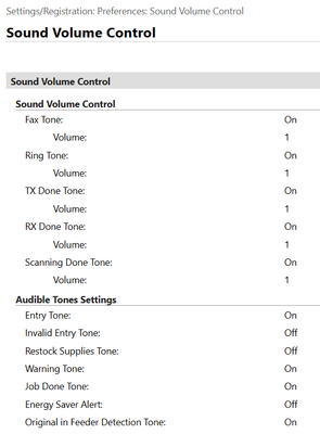

Remote UI, Settings/Registration, Sound Volume Control, Job Done Tone set to Off.

Interesting.  These are my settings.  I've never changed them.  My printers are in my office so maybe I've never noticed the sounds.
still beeping so I looked up this thread again.  Here are my sound settings:
I talked to tech support and when they couldn't figure it out they put me on hold, then came back to say it was beeping because my network is bad.  Not sure what that means but my other printer works just fine.  And never had issues with my network with any other device.
