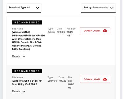

Unfortunately, telling me that you used the drivers on the product's support portal does not specifically tell me what drivers you installed.  There are multiple choices.
These two should be all you need for Windows 11.
