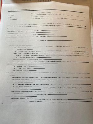

This is how it looks when I print with my Canon ImageClass MF453dw printer. I cant figure out what the issue is. Any suggestions?
01-30-2024 03:41 PM
Greetings,
This is likely a magnification function (setting) such as reduce or enlarge. It can also occur if a large image is printed and "Fit To Page" is selected.
01-31-2024 01:52 PM - edited 01-31-2024 01:55 PM
The settings might be in the in the Print Driver or in the application you are printing from.

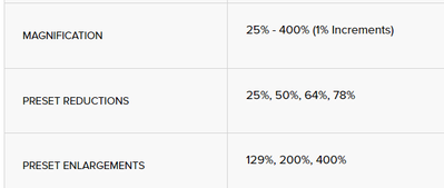

These are from the printer's Specs.
In the Printer Driver, look at the Page Set Up Tab
In an application, look for something like scale %.
