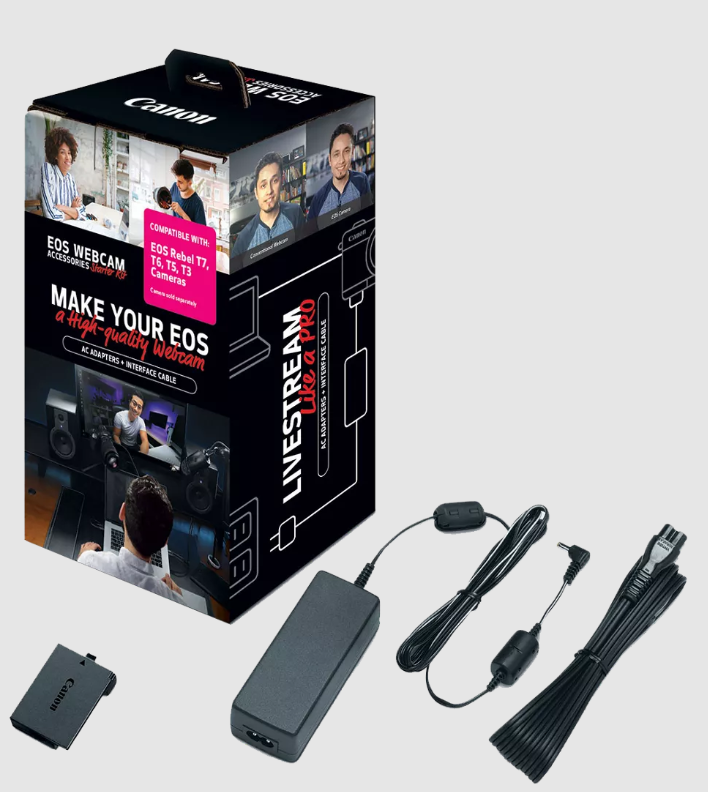

06-30-2024 01:33 PM
So then how am I supposed to porwe my camera while I am forced to use the USBc port to stream into laptop??
06-30-2024 01:45 PM
The Rebel T3i doesn't have a USB C port, nor can you power it with the USB cable.
For many of our DSLR cameras, you would use a Compact Power Adapter (AKA "dummy battery") and a DC Coupler. The DC Coupler goes into the camera's battery compartment, and the Compact Power Adapter plugs directly into it. They look like this:
