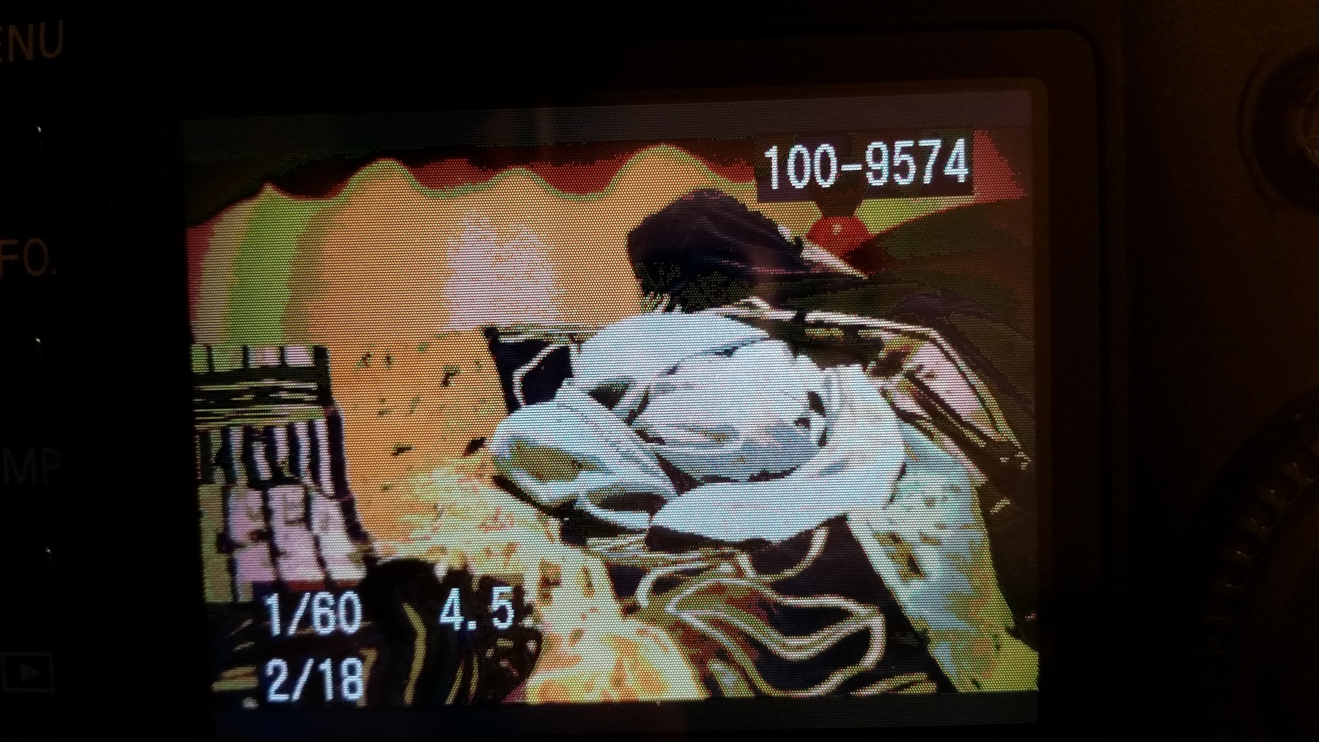

The phenomenon came all of a sudden when I switched on my long forgotten EOD 5D. It came exactly same as the description I found in an online forum.
http://photography-on-the.net/forum/showthread.php?t=821143&page=1

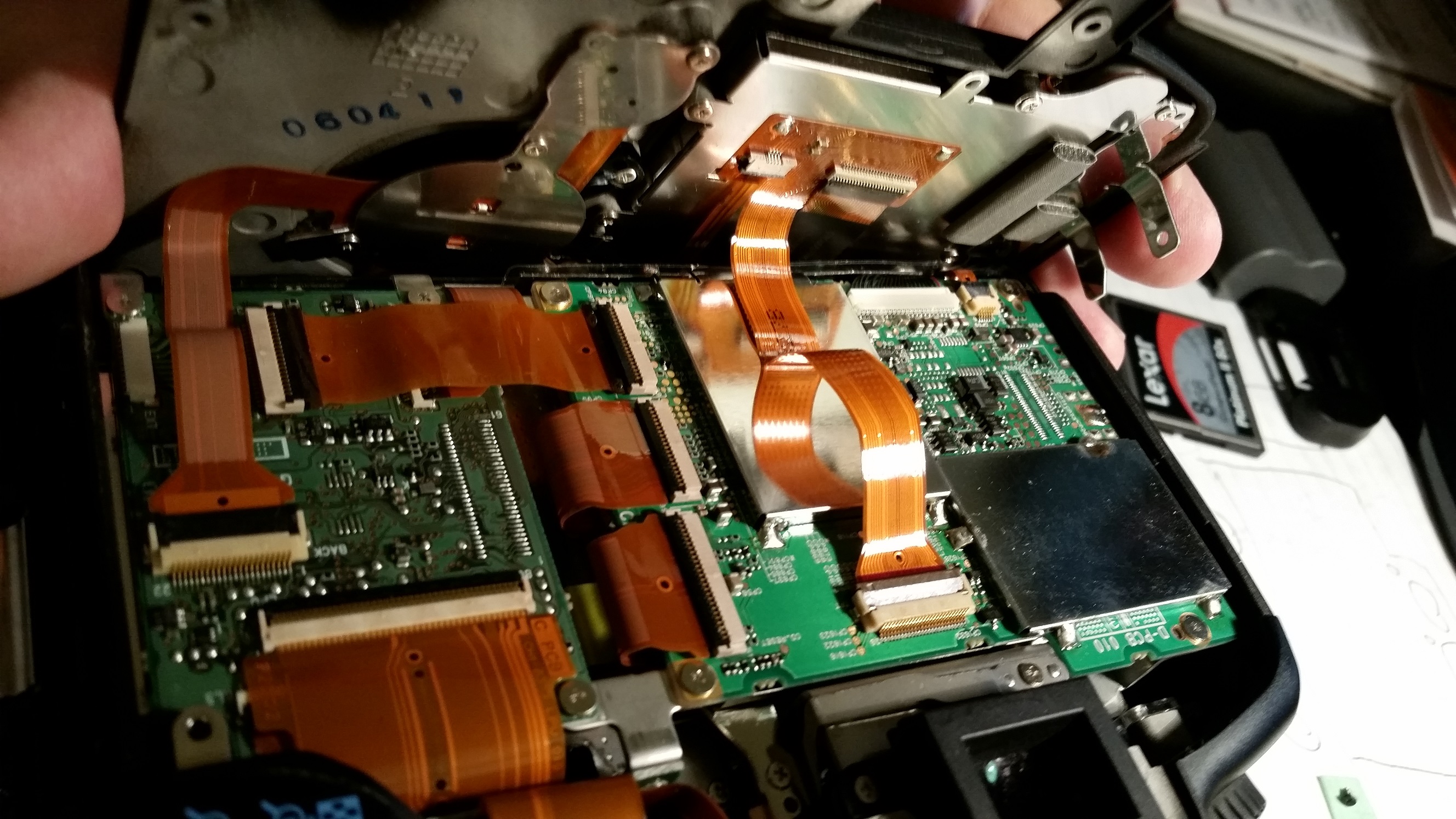

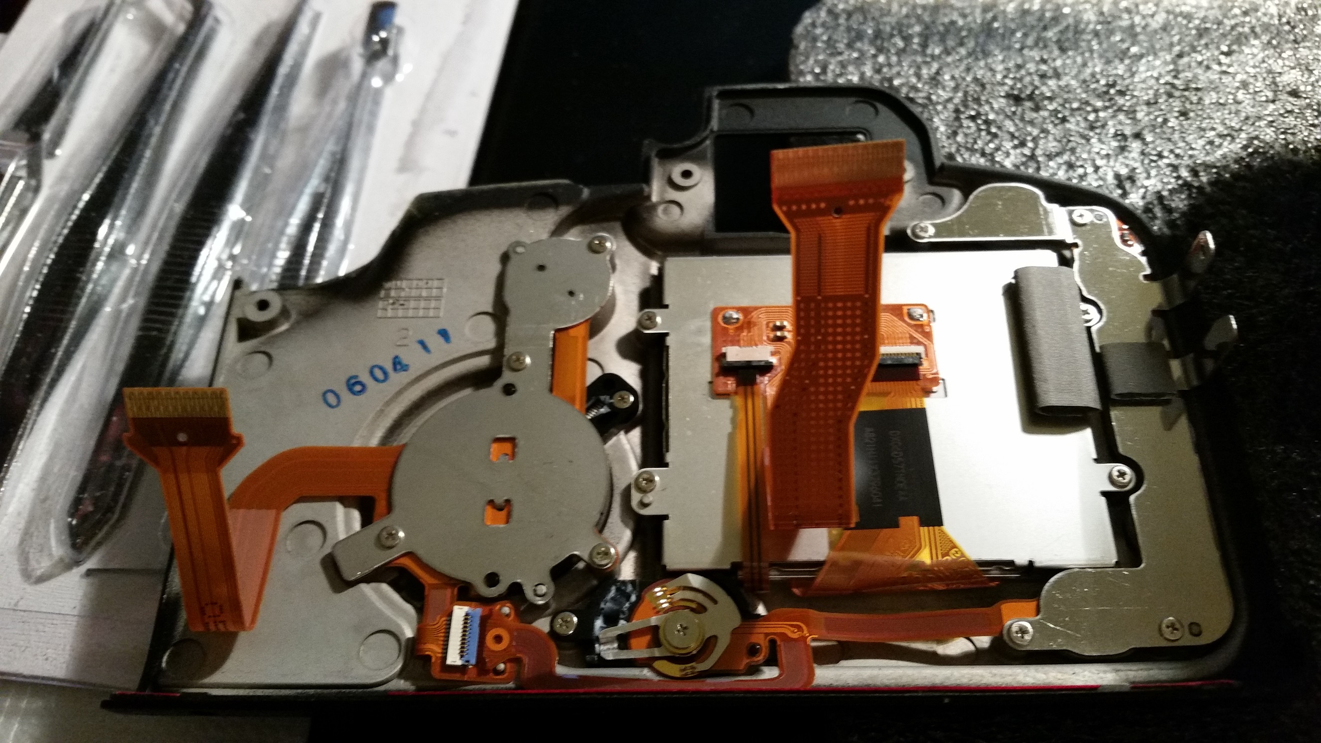

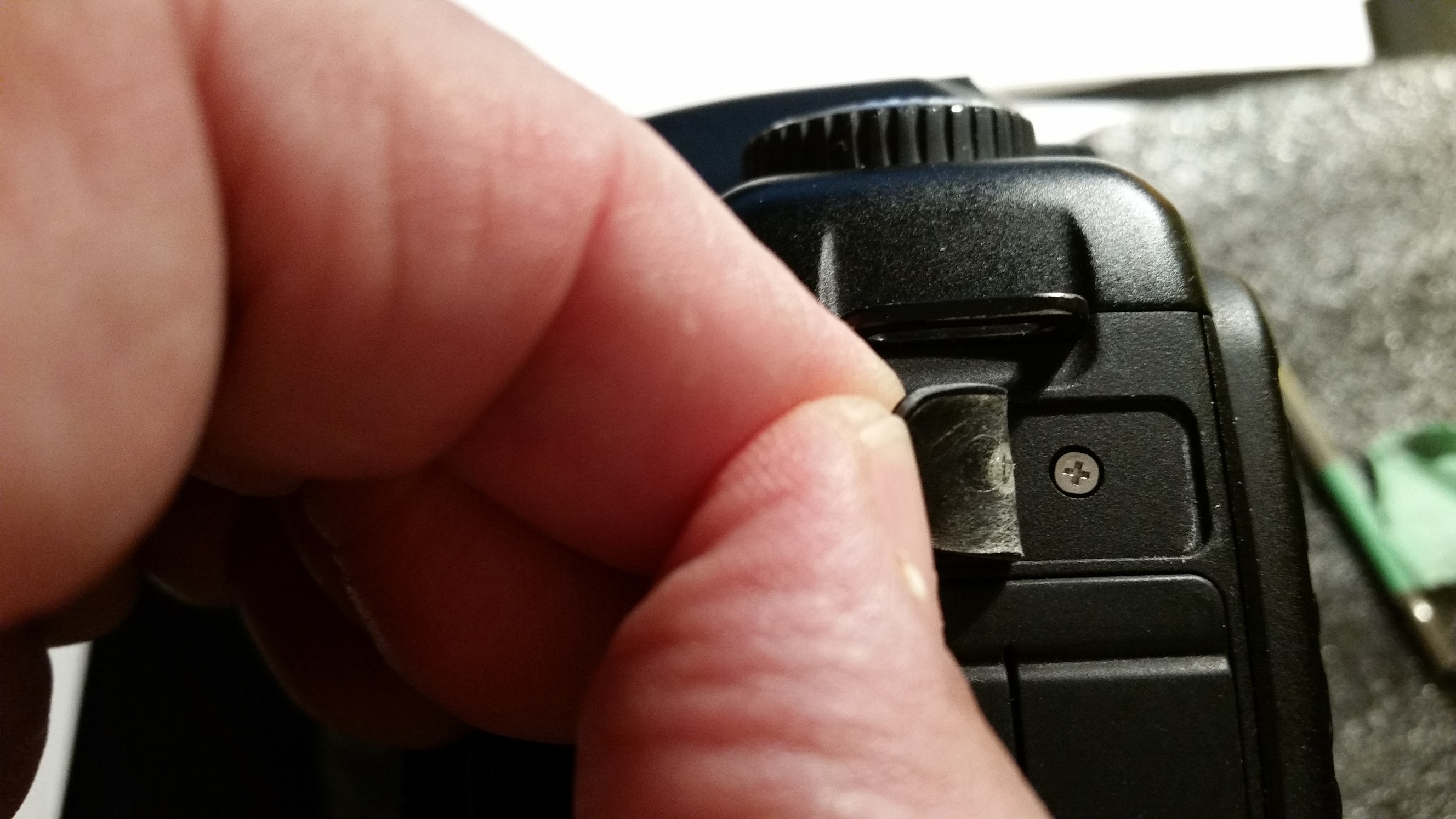

After some hesitation, I opened up the back plate of the camera to give it a try. As I have no idea how to open it and where to find the screws, I searched and found the video below.
https://www.youtube.com/watch?v=EEUQnqQtXgw
It's about 40D but it provided the information required. Both cameras are similar in design.

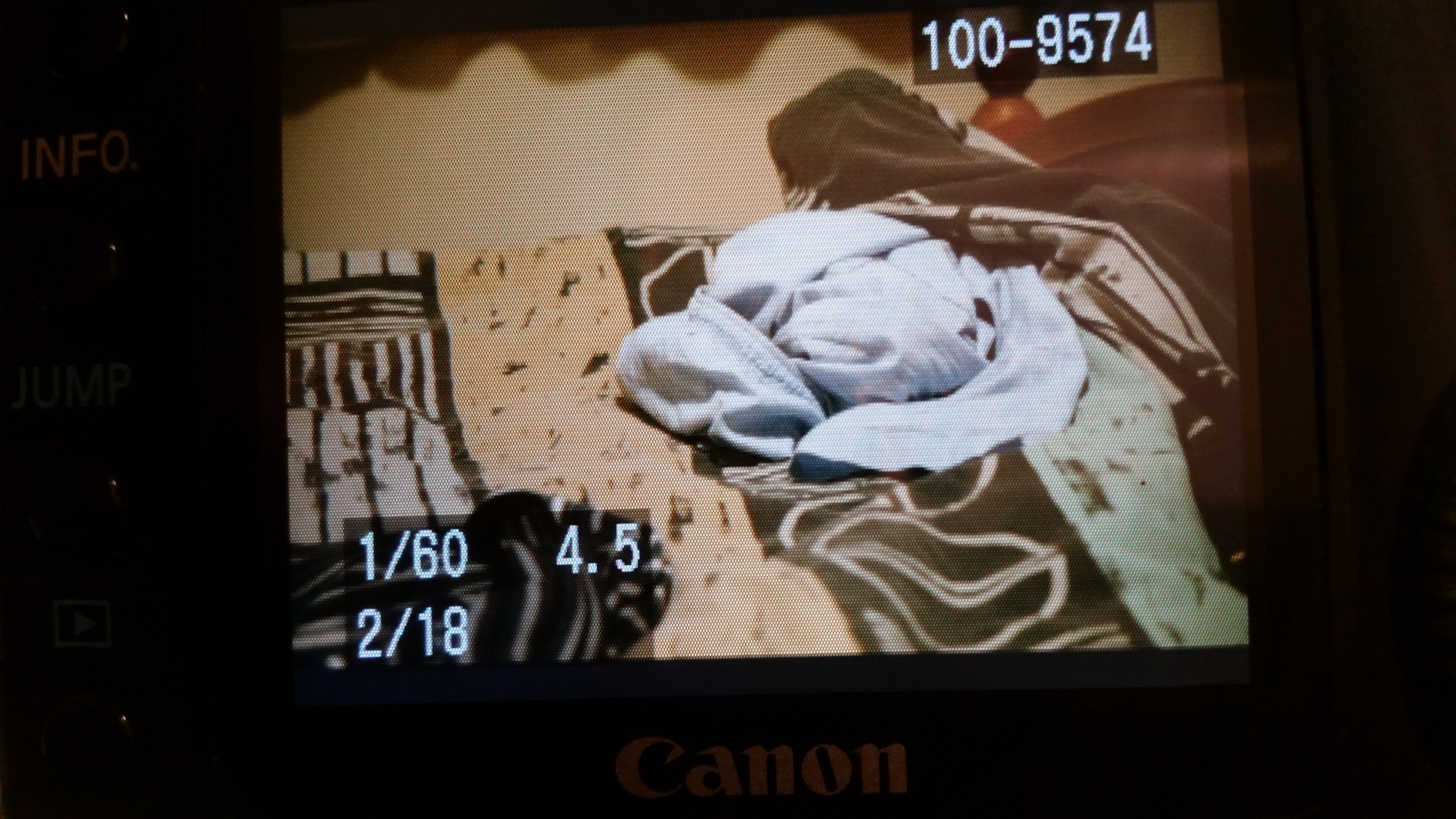

I removed the two flat cables. Inserted a pieces of foam under the loop of the cable connected to the LCD Panel. Removed the cable attached to the LCD back panel. Inserted it back and add a small piece of tape to reinforce and hold it in place more securely.
I put everything back and the LCD display is now back to normal.
