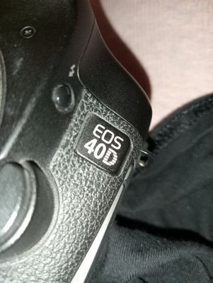

Hello!
I have never used a camera in my Life but i would like to start now. I have found a used Canon EOS 40d.
It may be broken but i am not totally sure.
I bought new batteries online since the camera i found had none.
The camera turns on. The small display on the right turns on, but the screen Is completely dead.
There Is no Memory card inserted at the Moment and the camera has no focus.
I would like to buy both but not sure if It Is worth since the camera Is not responding.
Thank you

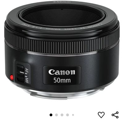

Do you think this lens Is suited for my camera?

That EF 50mm f/1.8 lens you pictured will work with the camera. EOS 40D is also compatible with Canon EF-S lenses, so you might consider one of those as an alternative. The camera was originally sold with either an EF-S 18-55mm or EF-S 17-85mm lens.

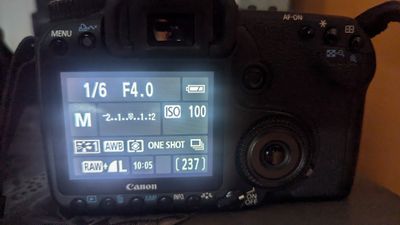

10-02-2024 10:03 AM
I would advise against using Amazon for camera gear related purchases. There is a high risk of Gray Market camera gear. I would stick to B&H Photo or any other Canon Authorized Dealer. Now as far as the camera body goes. If you press the info button while the camera is on. It will display the cameras settings. Like the exposure triangle and other stuff. This camera for some reason doesn't play nicely with large capacity memory cards. I personally use 8GB in my 40D. This camera as my colleague Brian has said. The camera has a very early implementation of live view. This camera doesn't support on image sensor AF. Instead the camera will drop the mirror and use the dedicated viewfinder AF system to AF. Also half pressing the shutter button doesn't work for AF during live view. You must press and hold the AF-ON button for it to work. For lenses with an electronic focus ring. The electronic focus ring is always active in live view mode. As long as USM lens Electronic MF is enabled. Live view doesn't work with the camera set to Auto or any other basic Mode. It only works in M, Av, TV & P Modes. As for speedlites go. This camera was the first in the xxD camera lineup to support the in camera flash menu. All EX and the EL-1 & EL-100 support your camera. Older Speedlites aren't compatible with the in camera flash menu. Another common kit lens with the camera in the U.S. was the EF 28-135mm F/3.5-5.6 IS USM lens. My camera came with that lens.
10-02-2024 10:06 AM
Have you tried pressing the info button. On this camera the screen is always black. Unless playing back a picture, using the menu system or pressing the info button to review settings.
