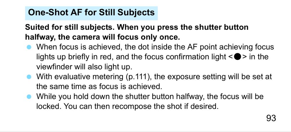

As I have pointed out earlier, One Shot AF mode locks exposure when it locks focus.  You half-press the shutter to lock focus, and you will need to maintain the half press to maintain the focus and exposure lock.
Evaluative Metering can bind exposure to any AF point.  All the other metering modes bind exposure to the center AF point.  The primary difference is the size of the metered area.
You can use Partial Metering, if you wish.   You will be restricted to only using the center AF Point. As long as you use One Shot AF and maintain the half press on the Shutter Button, you should not need to use the [AE Lock] button, at all.

Use only the center AF point with One Shot AF and any metering mode you wish.  The exposure gets locked when the focus is locked.
https://youtu.be/wKA92h0MfIE?si=SI7GTmsnLSFEElPP
With Evaluative Metering, you can use any AF point to lock focus and bind the exposure to it.  This was in the article that I posted a link to on page 1
