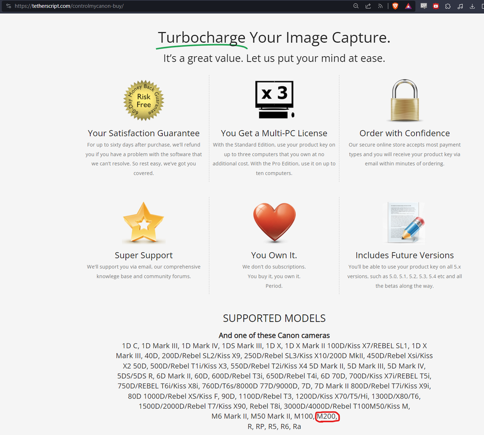

The ControlMyCanon website doesn't list the M200 as being supported by their software.

On the page I found https://tethertools.com/tethering-software/controlmycanon/ , it was not in the list. Can you contact them and ask them what the settings that you need are?
