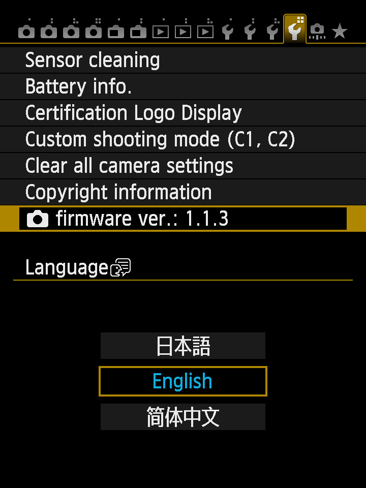

05-14-2015 07:06 AM - edited 05-14-2015 07:22 AM
Have you tried this yourself? The picture below is taken with firmware 1.1.2 and after that you can see yourself how it looks like updated to 1.1.3.
05-14-2015 01:06 PM
I have never before heard of cameras that required hardware changes to add/change menu languages. Certainly hasn't been the case with any Canon DSLR I've ever used (though I must admit I don't read and haven't tried to use many of those languages).
According to the Canon Europe website, the 5DIII should come pre-loaded with 25 languages:
English, German, French, Dutch, Danish, Portuguese, Finnish, Italian, Norwegian, Swedish, Spanish, Greek, Russian, Polish, Czech, Hungarian, Romanian, Ukrainian, Turkish, Arabic, Thai, Simplified Chinese, Traditional Chinese, Korean and Japanese |
According to the description, the latest firmware (1.3.3) "corrects some errors in the English and Russian" menus.
All this implies to me that a simple update of the firmware would solve your problems. That can be downloaded from Canon Europe or Canon Russia websites, I'm sure. It's worth a try!
It's easy to update the firmware.... just follow the instructions on the website carefully!
It appears they may have Russian versions of all the documentation (instruction manuals and quick guides) and Canon softwares (EOS Utilities, DIgital Photo Pro, etc.) available, too.

05-14-2015 01:22 PM - edited 05-14-2015 02:07 PM
The firmware you download from US, Europe or Japan is the same firmware and the latest for 5DIII is 17 961 776 byte.
You can buy a 5DIII in Japan with international menu, but it will cost you more than the one with Japanese/English/Chinese.
Here at yodobashi you can check the camera. It is written that it has three languages:
日本語 Japanese
英語 English
簡体字中国語 Chinese
Nikon Coolpix S02 has Japanese/English. Sony Rx1 was only in Japanese when I last checked in the beginning of 2013. The international menu camera cost maybe 100$ more.
