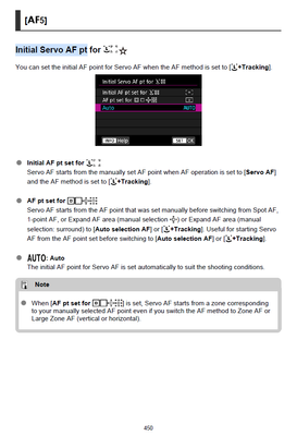

I’m trying to understand the three choices Canon gives me for the “Initial Servo AF pt for face detect”.  This is the top menu item on the AF5 menu.
I have played with the different options and I can’t figure out why Canon has given me these options.  What situations would one be more useful over the other?
What follow is what I think… there is probably something wrong here:
With either of the first two options selected, I can touch the screen to set or move the initial AF point.
Part of my confusion with the second option is the term “[Auto selection AF]”.  That appears to be the mode that the camera switches to when it starts out in face detection, can’t find a face, and then goes into [Auto selection AF].  But for me, with either of the first two options selected, if there is a face around the initial point, it quickly switches into the little blue squares dancing all around possible things to focus on when in Servo Mode.
Anyhow, I’ve played with this almost the whole day trying to figure out what the differences are and I can’t figure anything out.

Hi and welcome to the forum:
If you have not done so already, I recommend that you download the EOS R5 Advanced User Guide (Firmware v2.0.0 or later) as PDF to your computer and search for the phrase: "Initial Servo AF pt", you will get this:
cheers, TREVOR
