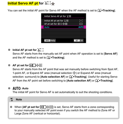

Hi and welcome to the forum:
If you have not done so already, I recommend that you download the EOS R5 Advanced User Guide (Firmware v2.0.0 or later) as PDF to your computer and search for the phrase: "Initial Servo AF pt", you will get this:
cheers, TREVOR
