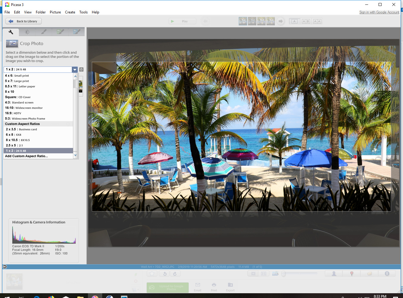

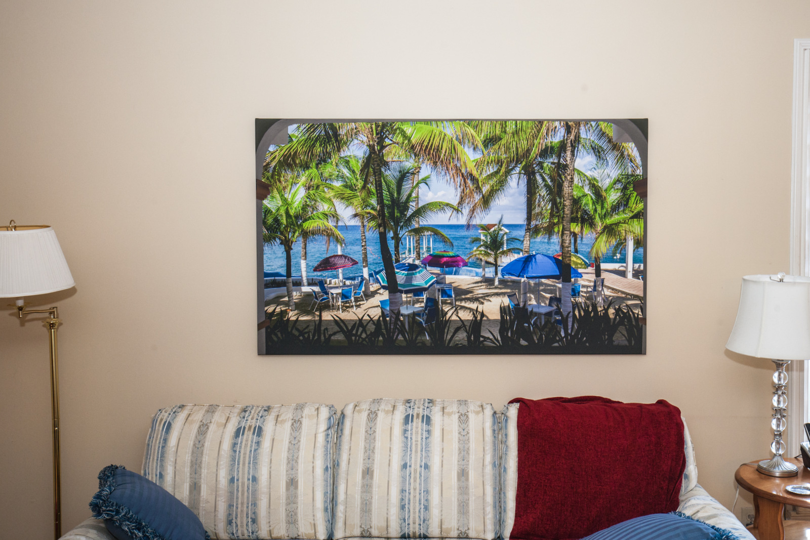

I'll go at this in a different way having recently needed to get a print on canvas that needed to be 36 X 60 inches. Before I start I needed it in landscape which matches my original photo but if you need it as portrait style start with a photo shot that way because you don't want to crop anything away unless necessary. Either way you should be cropping close to but not necessarily right to the wider sides of the photo. I prefer to shoot slightly wider than I want to print & crop as needed, but not severly. As already mentioned you want to start with a RAW file & after your edits save it as a TIF which creates a big file (that isn't compressed in the way it is to create a jpg.
I've used the free program Picasa to show what I do along with the un edited jpg of the file I had chosen. I created a custom crop setting for your needs & then used it to show what area of the photo you get but that crop box can be higher or lower but it can go wall to wall
Once I'm happy with my crop I export the file which is non destructive to the original because it creates a new version including the crop.

It might be a good idea to level the horizon before you crop Smiley Happy
True re the horizon but I did state that it was the un edited jpg. I did level the horizon in the file used for the canvas as well as spend a lot of time removing any CA along things near the sides (created by the wide angle lens used) as well as many other minor exposure corrections to the umbrellas, sand etc. The photo shows the view we see every day while on vacation in Cozumel while eating at the beach club restaurant. It had to be taken early in the morning to reduce the chances the area was filled with hotel guests but on many mornings the umbrellas weren't up & I wanted them in it. I had to try every day I wasn't booked to be diving.
Also when printing anything large I take 4 X 6 crops in areas which need details & print them. This was rather easy in this case because I only needed crops that were 10% of the total pixel width to have samples at the same resolution the file would be printed at. I do that a lot to check how an image will print before printing the full image. Saves a lot of ink should I have an area that looses the important detail at the desired print size.

That does look very nice.
Thanks. It did turn out very nice & was my wife's birthday present. I overheard her telling a guest it's the thing she thinks about on nights when she can't sleep and just thinking about it puts her to sleep finally. With that info I went down every day I could while she did her long walk hoping to get a perfect shot. The sun is very strong in the mornings but at the right angle but it did blow out a few areas which careful editing recovered.
