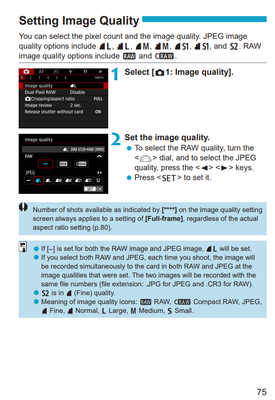

which image quality are you shooting with?  take a look at page 75 on the manual, you'll want to shoot at FINE/LARGE to get the best jpq quality.

Thank you for your help, yes, my image quality was on the wrong setting. So, should it be on RAW and fine/large always?
Shooting RAW is overkill for most casual photographers.  I shoot a lot but I mostly just shoot using JPG and rarely use RAW (too lazy to post process images).  However, for portrait settings, I will shoot both JPG and RAW (both at max settings) to get the choice later if I want to further edit the picture (you'll end up the 2 files for each shot).  Shooting RAW will eat up your disk space which is another reason why I limit using it.

I would say always capture RAW.  You'll never know if one day you want to edit your photos.  With JPEG, you're literally throwing so much information away.
To have the best of both worlds (maximum editing capability plus maximum convenience), do capture in RAW+JPEG at the maximum resolution settings for each.  If your camera additionally has cRAW (compact RAW), prefer RAW over that.
