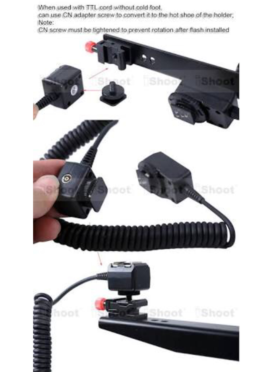

Do you know of any product that is flat that will slip into the camera's hot shot and will transmit the fire signal to, maybe a PC Sync or a hot shoe, allowing the camera hot shoe to still mount an extention bar?
Below is a cold shoe Extension bar with two cold shoe mounts on it's top but I will have to put a wire or wireless trigger on the camera then mount the extension bar on top of it. Most Triggers are made of plastic and is not strong enough to hold a 16' extension bar and 2 Canon 600ex-rt flashes (at least I will not risk my 600's like that).
Do you have any suggestions other than mounting the flash on a separate tripod mount?

You are not out of options. Photographers are a resourceful bunch and I am sure there is a solution available for you.
This may be exactly what you need. [link removed per forum guidelines]
There are other PC adapters designed to ADD a PC connection to your 6D.
You could also also use an ETTL cord with a built-in shoot through hot shoe.
Another option is a bracket system attached to the bottom of the camera which can free up the hot shoe.

08-04-2018 11:27 PM
Hi Mike,
Amazing!
Thanks you so much.
I think the bottom bracket with the flashes on either side of the camera looks like a great option right now.
Am looking for a tripod mounting screw long enough to run through the bracket and lock in the camera. If you know of a link, please search, until then, I am searching now.
