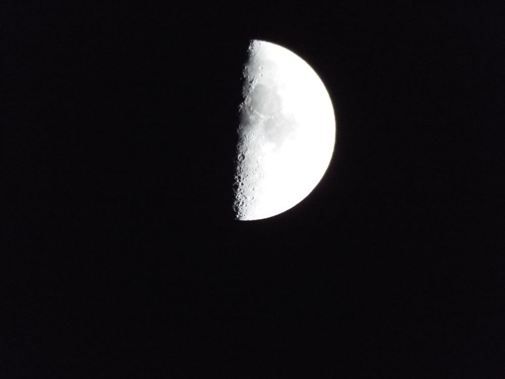

my pictures aren't coming out right what am i doing wrong? and the time is 24 hour not 12
this is from my Fujifilm 18mp 50zoom
this is form my Fujifilm 18mp 50zoomthis is form my Fujifilm 18mp 50zoom

I was looking at it from my cell phone last night when I responded. So I didn't notice the size difference until now looking at my laptop. You bought a great camera you just need a longer lens unless you crop in like your Fuji camera is doing. If you're going to be taking pictures of the moon you need to be using a longer lens. Your current EF 75-300mm F/4-5.6 isn't long enough. Its also not one of Canon's finest lenses. All of Canon's 75-300mm lenses aren't know for high quality. You would have an angle of view of 120-480mm when compared to Full Frame when using this lens.

You would need a super telephoto lens to fill the frame with the moon it. Just like the first picture you posted.

@booley wrote:
So was I misinformed and This wasn’t the right zoom to get?
For cameras like the Rebel large magnification telephoto lenses are rare and expensive. Canon makes a huge 800mm telephoto lens and it costs $17000. Depending how much you want to invest in astrophotography Sigma and Tamron make 150-600mm zoom telephotos, which will give you larger starting point.
You can get decent moon shots with your Rebel with a little work.
You may have missed focus. You want to be on a tripod and focus on the edge of the moon. The camera needs contrast to focus; half-on and half-off the moon edge to get that contrast. (Or focus in daylight and tape, like my previous suggestion.

Your third image had enough info to get a reasonable image out of it using Topaz Photo AI.
If you get proper focus and exposure you should get an image that you can crop to give a reasonable size image.

As John stated, a high magnification lens is quite expensive but the 150-600mm "super zoom" glass isn't horribly priced and I bought one last summer as one of my hiking lenses and I was very impressed with the performance given that it is a fraction of the cost of my Canon L series primes.  600mm on you APS-C sensor size camera provides decent magnification so you won't have to crop as much.  As others noted, you also have to nail the exposure and I would go with manually set exposure for the moon.
Some examples, the first photo is with the expensive Canon EF 800 f5.6 lens which still required a lot of cropping, the second and third are from a Celestron CPC-1100 HD telescope.
