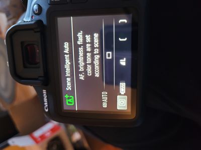

I got a camera three days ago. I charged the battery overnight and until about 3 pm the next day. I put the battery in the camera and turned it on and it shows two bars or 50%. I talked to somebody in canon and they told me that I should return the camera and have it exchanged. I said if I do that then I'm gonna get another camera and it will do the same thing. I have an older camera that does the same thing, with the battery at 2 bars. I went to clean the older camera and before the cleaning was done the battery was beeping and showed it was low. Somebody at canon told me that the batteries are on backorder for these cameras. The seller told me that canon ships the batteries at 50% and there was a charger for it. I would like to know what type of compatible batteries this would take because my boyfriend said to just keep it and get a battery from canon in a few months as they are on back order. At this point I'm unsure on what to do with it as it is my early Xmas present cause my other camera has no repair service if it needs to be fixed.

From the image, that shows the battery IS fully charged.  The stripes are not, in themselves, an indication of charge.  Solid white along the bar indicates charge and solid black would indicate depleted battery.  The stripes are more an idea of 66% and 33% values - like marks on a ruler.   As the battery discharges, the solid white will progressively be replaced by solid black from the left.  The stripes are just markers.
cheers, TREVOR
Canon EOS rebel t 7. I also have the canon EOS rebel t 5. Did the same to both cameras. So Im not a happy camper. Can't clean the t5 camera as the battary gets to low for it to finish cleaning. So why should I pay for it to clean it if the battary doesn't stay charged for it to clean. So yes this new one does the same thing and only had it since Sept. 28th.
That is the icon for a fully charged battery.
Not for your specific camera, but typical Canon icon:

Ok if that the case then I like to find out why I can't clean my canon EOS rebel t5 camera without the battery going low and beeping before its done cleaning

To add to John's helpful post, don't be put off by the reverse of black and white in the image, it's just because it was printed in the manual.  I have taken a photo from one of my cameras of the display for a partially depleted battery
