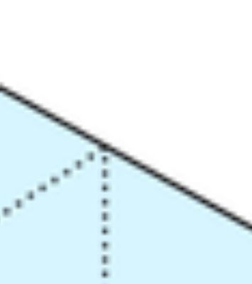

09-06-2026 07:32 PM - edited 09-06-2026 07:56 PM
“ That is not what he is talking about. He means the cover that replaces the eyecup when you are not at the camera, like on a tripod. Pentamirrors can leak. “
Correct! Your face is not there to block light from entering the OVF.
This diagram below shows where the metering sensor is located at the top of the viewfinder in a SLR or DSLR. Number 7 is the pentaprism. The metering sensor is located on the right side, where the vertical light path is reflected towards the left.
The cover is most useful when shooting in Live View, depending upon your shutter mode. The default Live View shutter mode drops the mirror and uses the metering sensor. You need to cover the OVF.
Or, you can have mirror remain raised, and use the image sensor for metering. No cover needed.

09-07-2026 02:40 AM
Thanks, Waddizle, for the very helpful diagram.
I'm currently working on using zones, so need an an accurate reading. My exposure meter is a critical part of that procedure.
I consider this a step forward.
