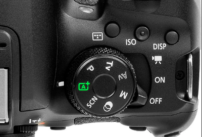

The image has the appearance that the onboard flash didn’t fire.  It probably should have automatically fired when using Intelligent Auto mode, Green [A+] on the top dial.
@Waddizzle On newer Rebel cameras the flash doesn’t pop up by itself in A+ Mode. The user must manually pop up the flash as if the mode dial were set to the Creative Zone (M, Av, Tv & P) modes.

“  On newer Rebel cameras the flash doesn’t pop up by itself in A+ Mode. The user must manually pop up the flash as if the mode dial were set to the Creative Zone (M, Av, Tv & P) modes.
-Demetrius “
I would beg to differ.  There actually two Intelligent Auto modes.  One has the onboard flash didn’t enabled, and one doesn’t.
@Waddizzle yes some older Rebels do but newer Rebel models just have Green Square/ A+ Mode on the mode dial. There isn't a separate No Flash Auto mode instead the user chooses if flash is used or not. It appears the EOS Rebel T6 is an older one with 2 different Auto positions. The mode dial on the EOS Rebel T8i lacks the No Flash Auto Mode. I didn't have the manual in front of me so I didn't know if that was the case for the EOS Rebel T6

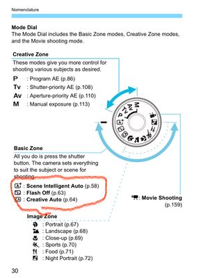

I am not following your logic. Non sequitor.

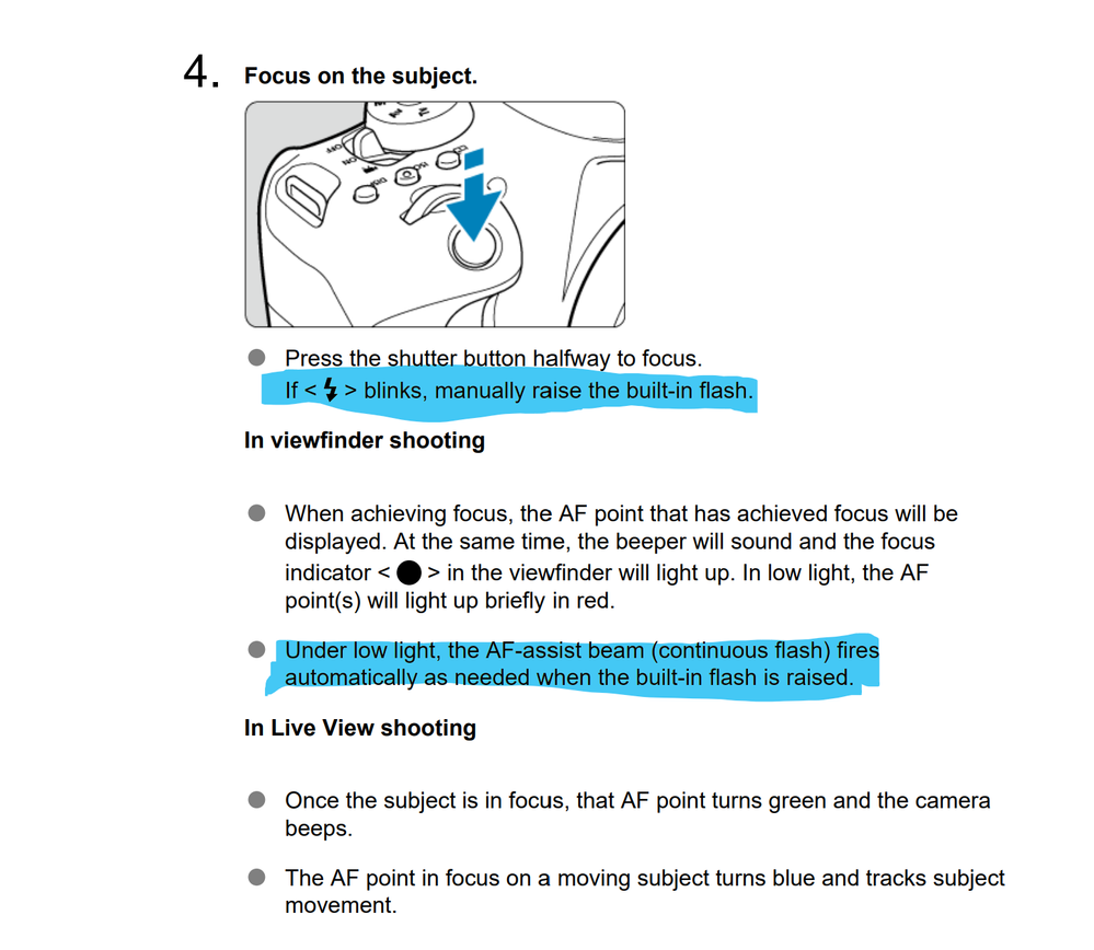

My screenshot is from the T6 User Guide, page number is shown.  The xxxxD bodies, T# in the US, were entry level bodies for absolute beginners.
The ###D bodies, T#i in the US, are entry level bodies. Two very different camera designs.
@Waddizzle now the pictures do lack flash. But I was trying to go off of knowledge I had of a newer Rebel regarding flash operation. But since the EOS Rebel T6 was an older model I had no idea that it actually had a dedicated no flash auto mode. But the pictures look clearly out of focus leading me to believe that AF wasn't working for some reason. Like the lens being set to MF so the camera would take pictures regardless if its in focus or not. If the lens was set to AF and focus wasn't achieved the camera wouldn't allow the shutter to fire.
