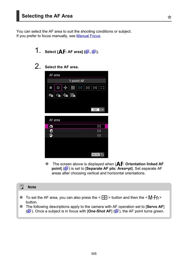

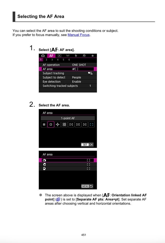

I am not following what you are saying.  The above schedule is confusing me.  The term “Face + Tracking? Is something that associate with using a DSLR in Live View mode.  I toook a couple screenshots of the R6m2 and R5m2 manuals.  I do not see the mode you are referring to.
