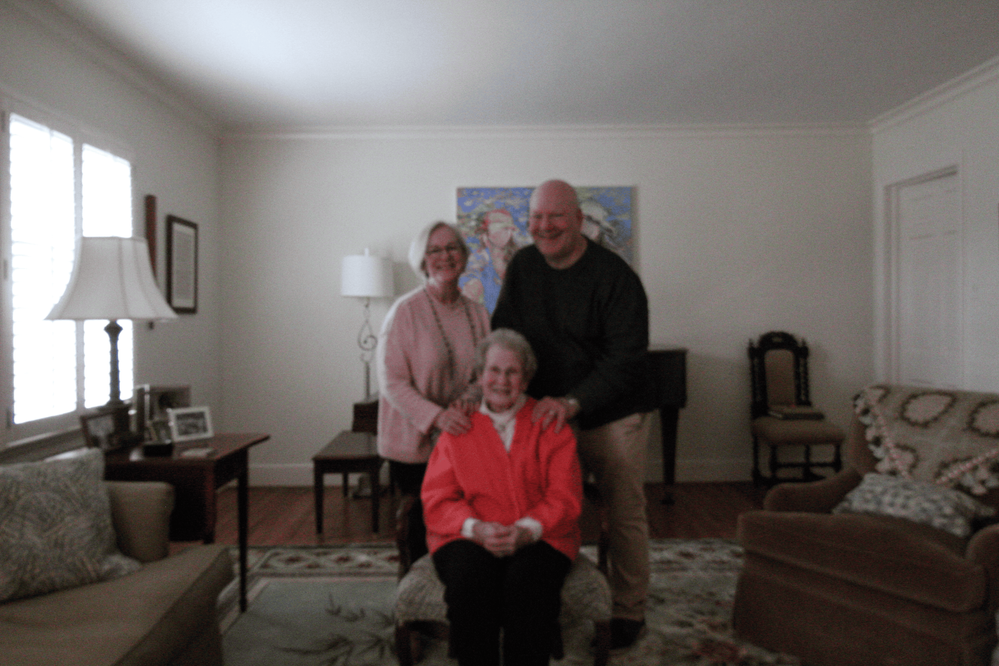

Here are two sample photos; they look blurry on the laptop, but fine on my camera. I am relatively new to this camera (receiving it about two months ago); however, I have done previous shoots since this, and the photos have turned out fine on the camera preview and my laptop before. In four camera shoots, this is the first time I have had trouble. The file sizes have all been similar, and outside of adjusting the camera dial between shots, I did what I have usually done.

@Matthew_24 Can you post a picture of the attached metadata for those pictures. Those pictures are definitely out of focus like the AF motor isn’t working or the lens is set to MF.

@rs-eos the pictures the OP posted look like the lens was set to MF instead of AF. This doesn't look like a shutter speed problem.
