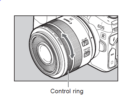

@busyretired wrote:From Canon USA - cost to change control ring click sound.
What is the Control Ring’s Clicking Sound Modification Service?
Canon’s control ring’s modification service offers RF lenses and Control Ring Mount Adapter EF-EOS R owners the opportunity to remove/reapply the control ring’s clicking sound.
The click action of the control ring allows the user to have a sense of how much it is being turned. However, if used during video shooting, the sound of the control ring operation may be recorded.
Pricing
Model Price* RF Lenses $79.99 Control Ring Mount Adapter EF-EOS R $59.99 *Tax and freight fee are NOT included
*All pricing is subject to change
Thank you, Customer Support Operations Canon U.S.A., Inc.
That illustration is not your lens. I do not think your lens is able to be modified like that. I am also certain that the "declicked" control ring is by design. After all, it is a focus ring. Most RF lenses have BOTH a control ring and a focus ring.
Your lens only has the single focus/control ring, which appears to serve a dual purpose.
[On lens has two control rings, and the other lens only has one.]
