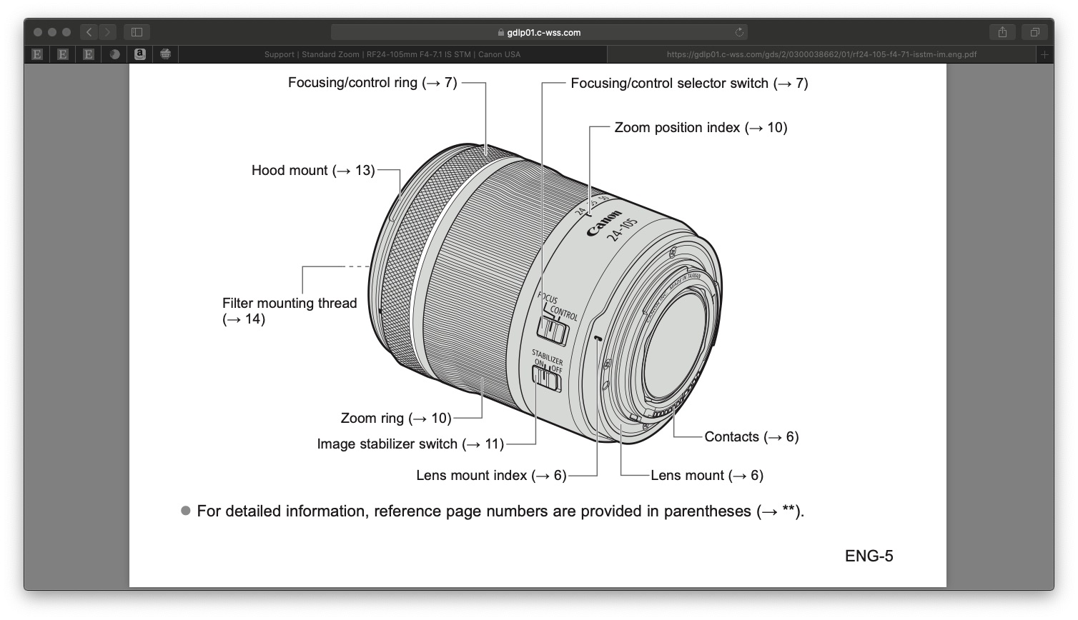

07-24-2020 10:12 AM
I finally got it solved - this lens has a switch on the barrel I didn't notice.
The front ring functions either as a control ring or focus control depending on switch position.
It works fine as a control ring now but doesn't click like other R lenses.
It must come from the factory with the click silenced.

The focus ring *is* the control ring:
07-12-2020 12:55 AM
Hi there,
As shown in the diagram above, the control ring functions as the focus ring as well, dependant on where that [control/focus] switch is set to. When this switch is set to control and the camera is autofocusing, and the camera is set to one of the manual modes (P, Tv, Av, M) do you see any action or change when rotating the ring even if there is no click?
