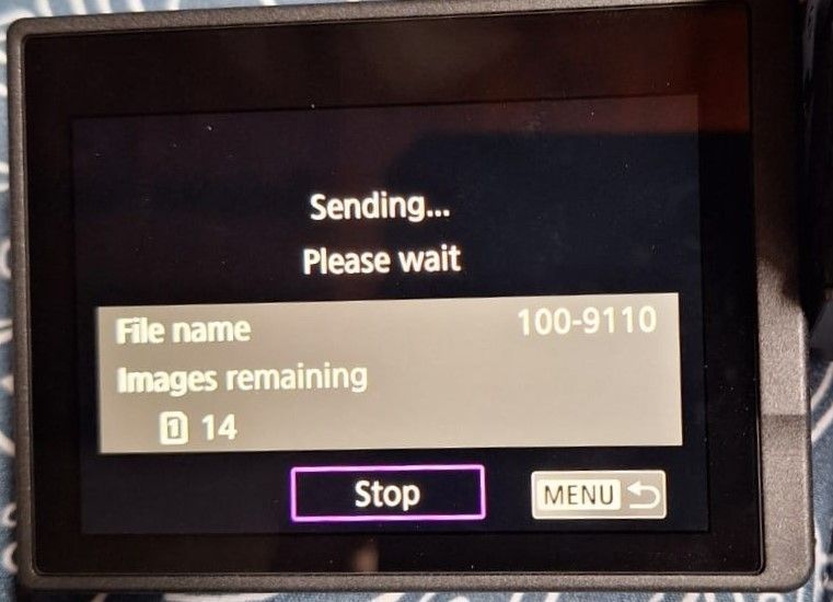

I recently installed image.canon, but noticed that automatic transfer was enabled. So every time I look a photo and want to delete it, the camera tells me it's sending. The trash button becomes unusable.
Uninstalling the app on the phone didn't help, and in image.canon website doesn't offer an option to disable this automatic transfer.
What can I do to get the trash button back to normal use?

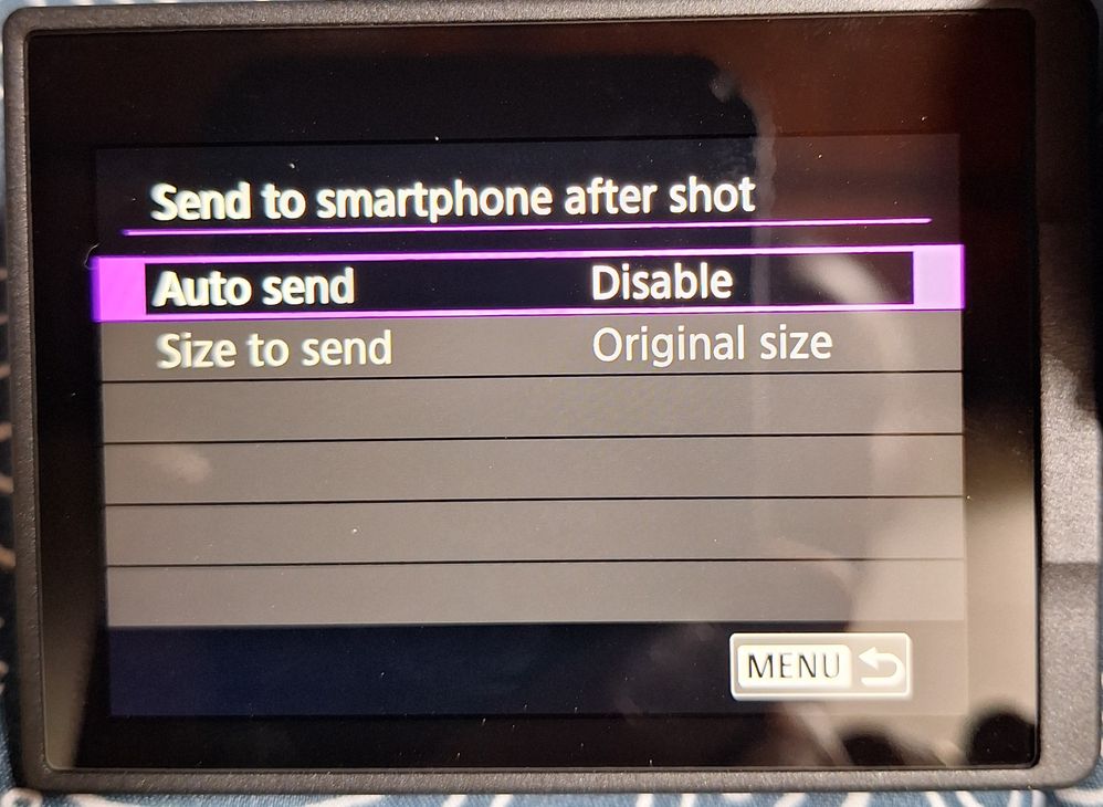

The automatic transfer is disabled through the camera menu. To do that press the Menu button on the camera, go to the Wi-Fi tab, select Wi-Fi Settings, and set Send to Smartphone After Shot to Disable. Once you've done that the camera should stop automatically transferring your images giving you the chance to delete the ones you do not want to keep.
06-19-2025 03:50 PM
The "Smartphone After Shot to Disable" was already so
