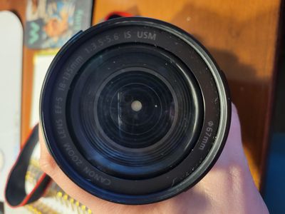

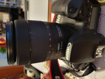

I was shooting a wedding and half way through it I started receiving this error. I switched lenses and it continued, so I had to use my older camera. Please help!! What do I need to do?

Does the camera show an aperture set or does it say F/00 or F/—. If it does for some reason the camera and lens aren’t communicating. Do other lenses work properly on that camera. That lens utilizes an electronic focus ring so if the camera and lens can’t communicate manually focus doesn’t work either. All the focus ring is connected to is a digital encoder. When you turn the focus ring with the camera set to One Shot AF. The lens sends a signal to the camera which way you’re turning the focus ring. Then the camera sends a signal back to the lens to tell the AF motor to carry out manual focusing.

Set the aperture to a small number such as F/11 or F/16. Then press the depth of field preview button. The lens should stop down to the selected aperture. If Error 1 pops back up it’s a lens problem. By default the lens aperture stays open when focusing and composing your shot. It stops down before the picture is taken.

Note this is not a fix. You likely have a failing aperture motor, flex cable or sticky aperture blades that aren’t always stopping down. Newer cameras utilize faster communication speeds between the lens and camera. Older lenses with failing flex cables make work fine on an older. But on a new one it could cause problems.
