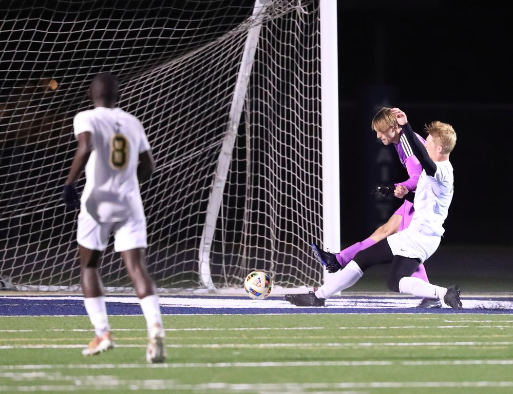

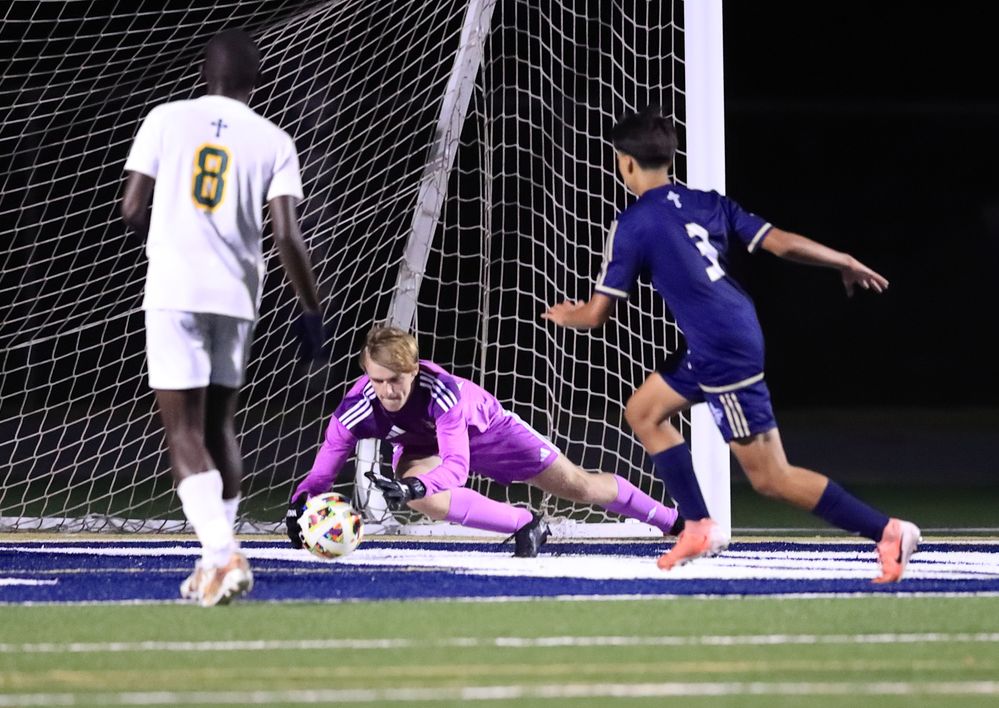

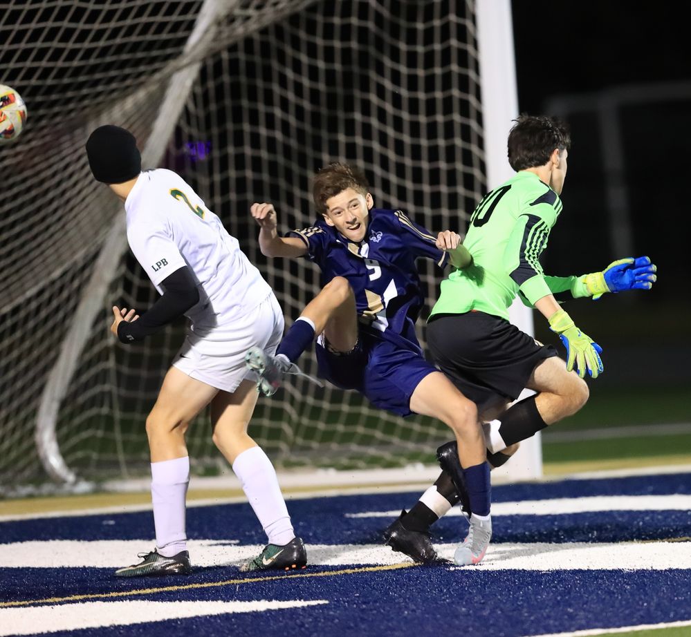

Shutter speed of 1/1,000 is fast enough to freeze motion in youth soccer so no need to go higher when the combination of illumination and available aperture are pushing ISO higher. Although 8,000 isn't a problem with current cameras, the images below were shot with 1DX III bodies with 70-200 and 400 f2.8 glass with ISO from 8,000 to 16,000 and I regularly go up to 25,600 during football season.
Location is critical and most youth soccer facilities allow fans to get pretty close to the action which makes photography easier than higher level where fans are further removed from the pitch. With a 100-400, you shouldn't need to use the 1.4X extender as 400 plus a bit of cropping will cover the field pretty well from a reasonably central location and an extender will degrade image quality so use only when absolutely necessary. For daylight high school games, I have a 200-400 with integrated switchable 1.4X extender on one body and with it I can cover offensive action coming at the goal from a position at the end of the field and with the 1.4X switched in it provides good coverage of goalie saves at the other end. In this case the daylight keeps ISO very low even with the extender in and the Canon EF 200-400 f4 extender lens is a very sharp lens so the degradation from switching in its integrated 1.4X extender is acceptable but still not desirable.
For sports, I typical use single point with four point expansion which gives the camera a little more to work with on some uniforms to lock focus immediately. Soccer is a fast moving and changing sport and I have found Case IV works well for both soccer and football but experiment to see what AF servo characteristics work best for you.
Don't get in the bad habit of trying to lean too heavily on drive speed but instead stay fully engaged with the action. The better you are at predicting the action, the better quality images you will capture. Most of my captures in sports are singles with a few 3 to 5 image bursts; in most cases if you finger is on the shutter release for more than a split second you are primarily capturing "garbage".
