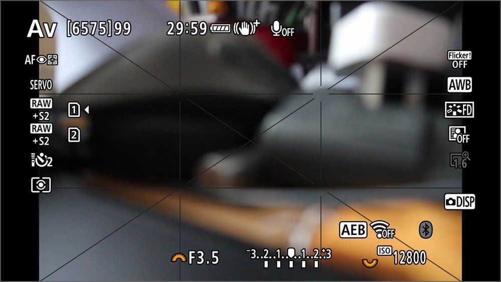

I have a bracket on my screen that I cannot remove. I am sure it is an easy fix but I can't figure it out

Marylou,
Just to clarify what we are talking about, is this a bracket around the viewfinder display, or exposure bracketing?
This first display is auto exposure bracketing, you can see the icon AEB in the lower right and the multiple marks below the exposure scale. This will be reset if the camera is powered off and auto bracketing cancel is enabled, which it is by default.
The other type of "bracket" might be to do with AF settings. Here you can see an AF point at the centre, but white "bracket corners" near the edges of the frame. This one occurs when the AF method is face + tracking and you have chosen not to use the auto setting for the initial AF point with servo AF. If the initial AF point is set to anything other than auto, the white bracket frames indicate the limit of where you can position the initial AF point.
