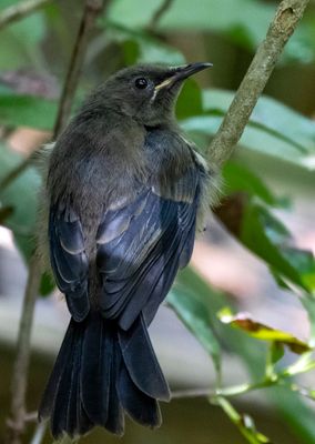

In these two the subject was about 15m (30ft) away and further challenging was the very dim light in the deep bush and almost identical tonal and colour characteristics of the bird relative to the background Original in bush
Image blown up
Virtually no tonal difference here
