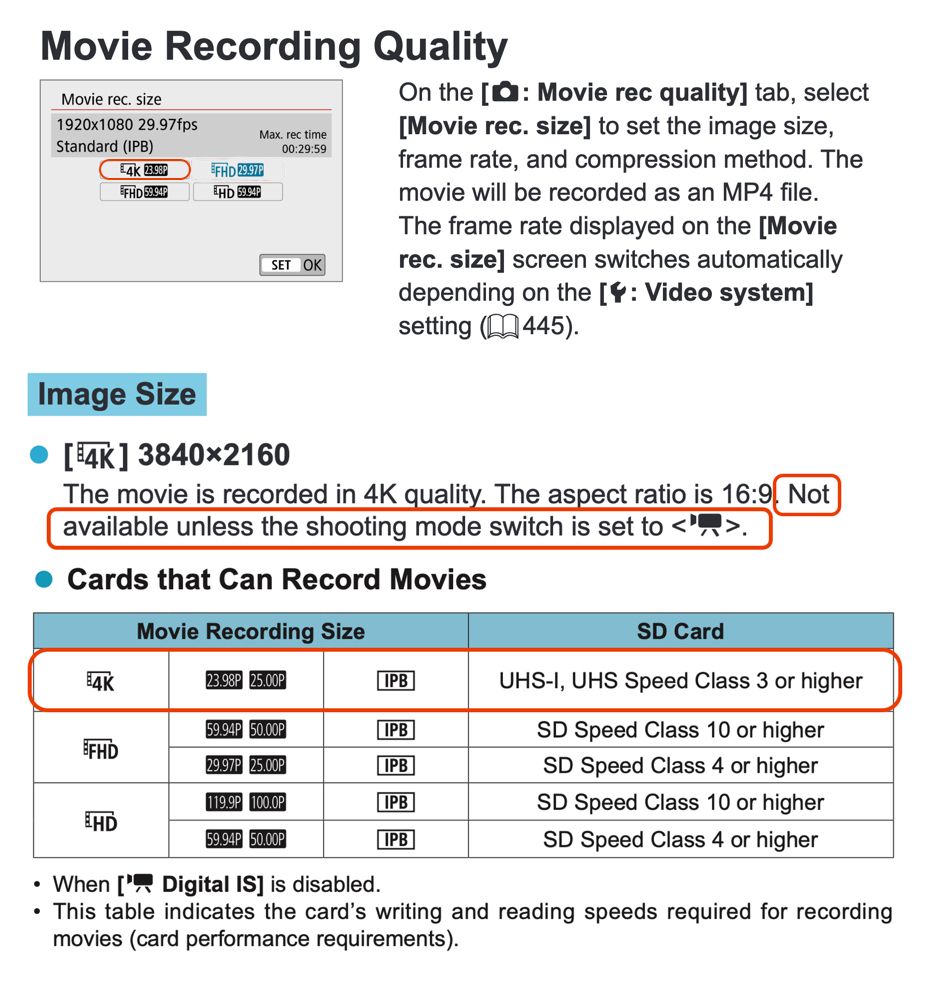

Hi i just opened my m200, I do not have the sd card yet, however i went through the menu features. I did not see the 4k selection just the 1080. Does it need the sd card to show the 4k selection in the menu? If not i will be sad. I bought it for 4k. Anyone know?

The M-200 certainly can record movies at 4K. To do that you must:
1. Install a SD card specified for UHS-1, UHS Speed Class 3 or higher.
2. Be sure the camera mode switch is set to "Movie" mode only.
3. DISABLE Digital IS
4. THEN Set Recording Quality to "4K 3840 X 2160" (4K is limited to 16:9 aspect ratio only).
See highlighted menu settings attached.
Hope this helps
