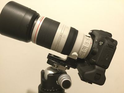

“ Would you suggest it’s a good tool to use and I should stick with it for long exposure etc. Any tips, advice welcome. “
A robust tripod and a robust tripod head is a must have for long exposures. You don’t want the rig to wiggle in a breeze. You don’t the head to exhibit backlash when you tighten it down. That means the head will shift the direction the camera is pointing as you tighten it down.
The heavier your gear, the stronger the support needs to be. A high quality head is the most important investment you can make for long exposures.
