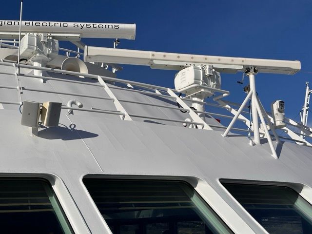

I did some more experiments.  I'm now 6 for 6 in having this happen at that specific location (and nowhere else).IMG_8091 Medium.jpegIMG_8091 Medium.jpeg.  The front of the ship 3 decks down doesn't have any problems.  I tried putting the camera in Airplane mode and it didn't make any difference.  I'm sometimes able to get off about 2 shots before it locks up.  Sometimes the lockup occurs when I'm composing the shot, and the image turns red for a couple seconds and then black.
I attached an image looking back from the location where these issues occur.

Those are radar antennae - I assume they are rotating as they don't look like phased array antennae (non-rotating, pointed via phasing of the beams).
If the lock-ups happen when a circuit is overloaded due to the electromagnetic field effect (generating electricity inside your circuits) there would be no message as the shutdown is anything but graceful.
