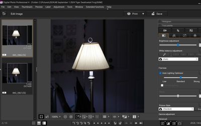

When shooting through the VF: I'm not sure how it works with anything but DPP, which is my primary raw editor, but on my DSLR's, I leave aspect ratio in the shooting menu at 3:2 and select the ratio I want in the C.Fn4 menu (on the 7D II) "Add cropping information". This will bring it into DPP at the ratio I pick. You can get the 3:2 back by clicking the "Clear" button.
When in LV: I set my ratio in the shooting menu. It comes into DPP just like as described above and I can leave it at that ratio of clear it back to 3:2.
This is a screen shot from DPP 4 with the cropping info added as described above. I used 6:6. You can add a grid if you like and resize your ratio.
This is the same shot from the 7D II with the aspect ratio cleared.
