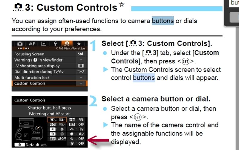

@4calaverigary wrote:
I previously set up C1, but I'm not trying to shoot in it, i.e., I don't have it selected.  Thanks for the link to the electronic manual.  I had previously downloaded it.  Even so, when I try to trouble shoot my problem I can't find a solution that works for me.  Thanks again.
You need to look at the "custom buttons and dials", particularly the "Multi-controller", which is what is going to allow you to select focus points. See attached screen shot of the users manual below. IIRC, it is off by default, so once you scroll to it, press "Set", then enable it.
Multi-controller Function.Multi-controller Function.
It's been a while since I've used the 7D mark II. I just pulled it out to make sure of this and had forgotten how big it is, LOL! I've been shooting with the R5 and R6 for a couple of years now.
I hope this helps 🙂
I hope this helps 🙂
Newton
Check the setting for the control just below Newton’s Red Arrow, the one all the way at the bottom of the right column.
When you enter this menu screen the camera display on the left side will change to highlight the different buttons and controls that each selection on the right side is associated with.
I believe the default setting for this control is DISABLED.
