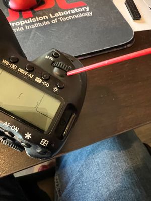

The main dial on my 5D is no longer working properly: only every 3 or 4 turns does it do anything. Very frustrating when trying to select aperture.
Two questions:
1. Has anyone had the dial repaired through Canon, and what was the cost?
2. I could reassign the main dial function (aperture) to another button, but which one?

08-11-2023 01:39 PM - edited 08-11-2023 01:41 PM
Don't know specifically about the 5D Mk IV, but Here's a story for you.....
I inherited a 50D, beautiful in every way but one...the Main Dial would turn without doing anything. Sometimes it "engaged", mostly not. I researched this, found lots of advice to replace the shutter button/Main dial unit. I was close to junking the camera, as DSLR disassembly isn't my thing and paying for repair didn't make sense to me. One more web search produced an article about how the 50D was prone to having the rubber "tire" on the Main Dial starting to slip, so the tire was turning but not the wheel. The fix was to carefully lift the tire with a toothpick in a couple of places and carefully place a small drop of glue under it. Very small, so it didn't ooze out from under the tire.
End result, the tire stopped slipping, the main Dial came back to life, and I've been using the 50D for years since. Works perfectly.
08-12-2023 05:47 AM
Sounds like a good solution, and I see many have done this successfully. However, the rubber 'tire' on my 5D isn't pliable and I can't get it to lift up to reveal the plastic wheel underneath. Guess it's over to Canon to deal with.
08-12-2023 11:18 AM
"...it's over to Canon to deal with."
Where it needs to be. Lotta difference between a 50D and a 5D Mk IV.
08-12-2023 12:26 PM
Who knows what models beside the 50D can have this problem?
08-13-2023 11:19 AM
Possibly none! "... the rubber 'tire' on my 5D isn't pliable and I can't get it to lift up ..." or it might just be a xxD issue or even just a 50D issue.
03-25-2024 03:32 PM
I know this is an older post, but one of my 5D MK IVs was having this same intermittent dial issue, sometimes adjusting shutter speed the opposite of dial direction. I sprayed some Electronic Parts cleaner in/around the dial and worked the dial in each direction while it was drying. It took a couple of applications, but seems to have completely fixed the issue. Many people seem to have this issue, so hopefully they'll find this.
03-26-2024 11:42 AM
That would not be my first choice of action and I will advise folks to not do that. Who knows if it worked or was a coincidence but spraying cleaner in an area you can't see in is not a good idea, IMHO, of course.
