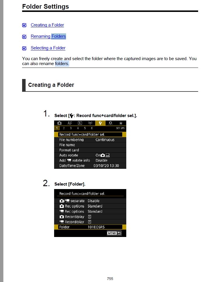

I've attached a screen grab of page 755 of the R5's Advanced User Guide. You just need to scroll over to Wrench 1 and create a new folder and set it to current. It just takes a few seconds. Once you select "Folder" at the bottom of step 2, you will get more options. I have folders already made so I just select an empty folder and shoot my stack. Just don't forget to go back and change to your main folder when done, LOL!

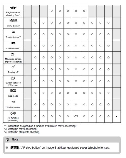

It looks like folder+ function (Create Folder) can be assigned to a button. See pages 841-843 in the manual. I don't have that camera, so I can't check it out myself.

08-11-2023 09:08 PM
Looks like a possible solution but it requires one to give up an existing button function for something that might not be used very much. Focus bracketing is useful only for static objects. I use it for macro work, especially insects some of which occasionally remain stationary long enough to be applicable.
Seems odd that a feature recommended in the interface isn't found in the interface.
But that's a nice catch! Thanks for the idea, I'll certainly keep it in mind.

You do not need to re-assign a button to create a new folder for storing images. Use the blue Playback menus to create a new folder and then to tell the camera to store images there.
08-12-2023 03:17 AM

08-12-2023 03:30 AM - edited 08-12-2023 07:00 AM
Thanks for the correction, Newton. I thought the setting was in Playback Menus.

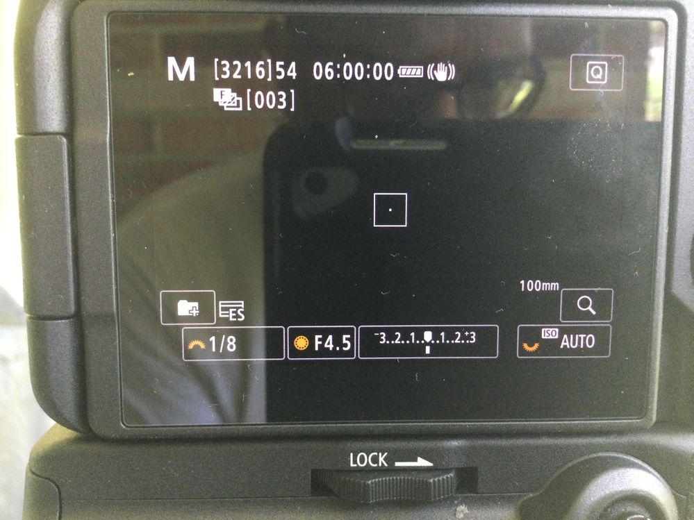

08-12-2023 01:52 PM - edited 08-12-2023 01:59 PM
It works for me. I enabled it and press [INFO] until this screen appeared.
The icon you want is on the lower left. There is an icon that appears when it is enabled on the upper left.
[EDIT] You must have “Touch Control” enabled!
