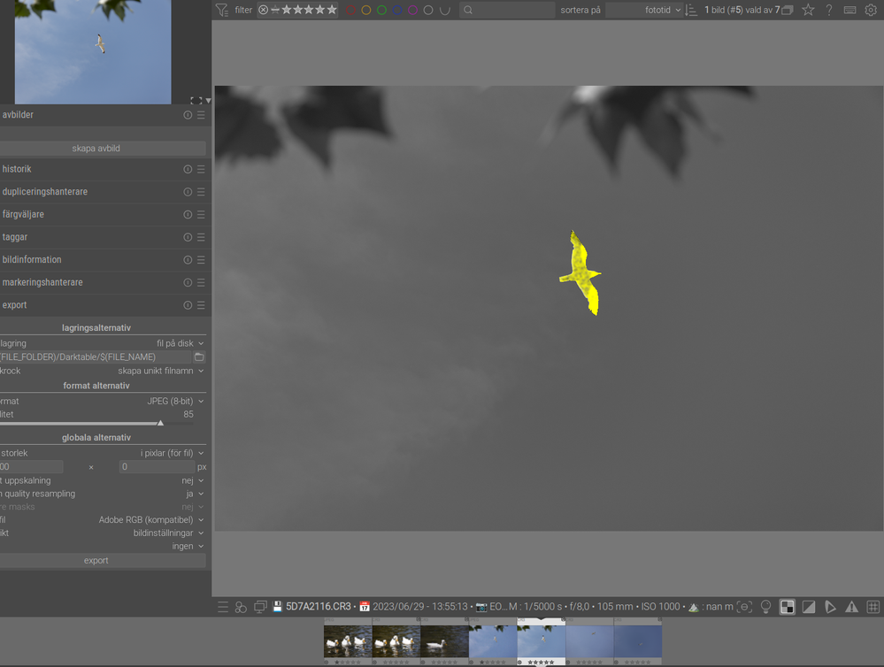

Seems good. I also have R6 and I see nothing wrong with your raw files. Noise is more visible when there are no details. For example a blue sky.
Sharpening a picture will also make the noise more visible in a blue sky if you choose to sharpen the whole picture and not just the details.
Sharpening masked area only.Sharpening masked area only.

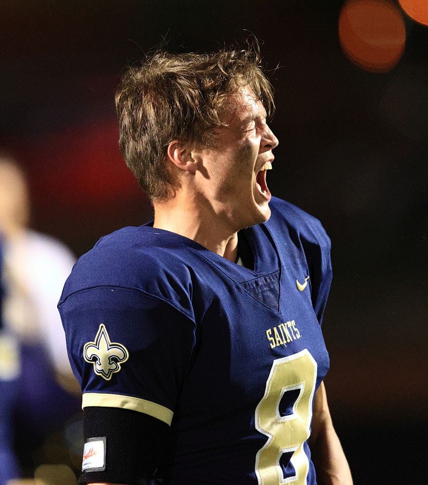

The biggest gains in sensor technology in very recent years are at much higher ISO settings and that, along with better AF, make it possible to get good captures under conditions where that was previously somewhere between very difficult and impossible.  Those areas are where your newer camera will show a major advantage.
I shot this first photo of a bee using my then new 1D Mark II (2003 introduction date) a couple of months after I bought mine in 2005.  It has a 8 MP sensor and maximum ISO of 3200 with anything 800 and above being nearly unusable.  But under good lighting, it did a nice job and the bee was captured at ISO 400.
But with my 1DX III bodies, I don't hesitate to shoot sports under conditions that push the ISO to 20,000 or higher and that is where more recent sensors show the advantage over older models.  The first football image was at ISO 12,800 and the second at ISO 16,000.
Action photos of wildlife and sports are sometimes going to force a higher ISO and there will be noise.  Most people won't be looking at a photo with a magnifying glass looking for noise, if the capture features good composition of an interesting subject then that is what people will see.  It is another version of the forest and trees saying.
Rodger
1DM2 EF 100 f7.1, 1/640, ISO 4001DM2 EF 100 f7.1, 1/640, ISO 4001DX MIII EF 400, f2.8, 1/1000, ISO12,8001DX MIII EF 400, f2.8, 1/1000, ISO12,8001DX MIII EF 400, 1/800, ISO 16,0001DX MIII EF 400, 1/800, ISO 16,000
